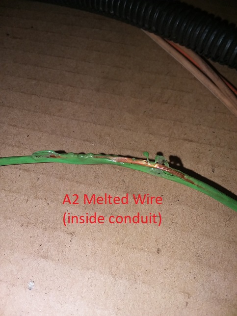

2) I traced the A2 light green wire that was melted closest to the battery and discovered several areas inside the conduit that were also melted. However, there was no collateral damage to any of the adjacent wires in any section where the Light Green wire was running, melted or not melted. This seems like a good development and if it wasn't for observation #3 I would clean and remake my harness and reinstall. This picture shows one such thoroughly melted area, but again, neighboring wires weren't melted or discolored at all.

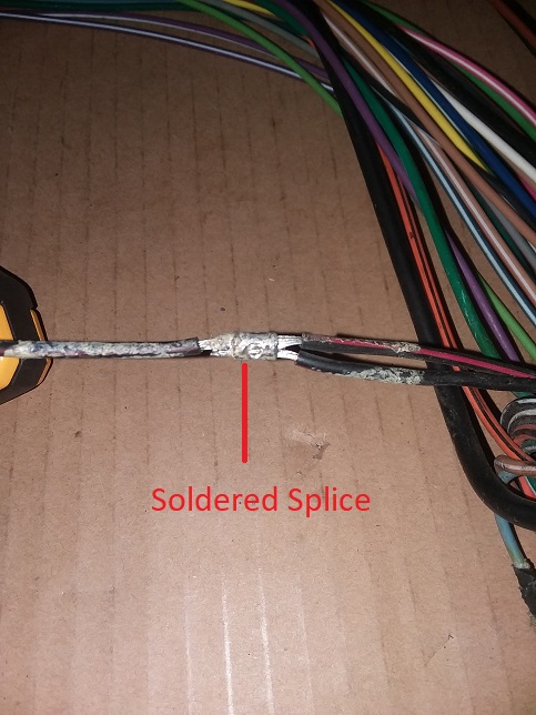

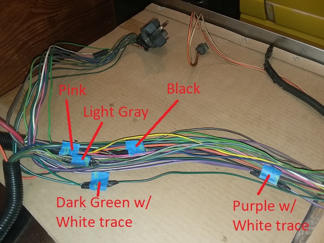

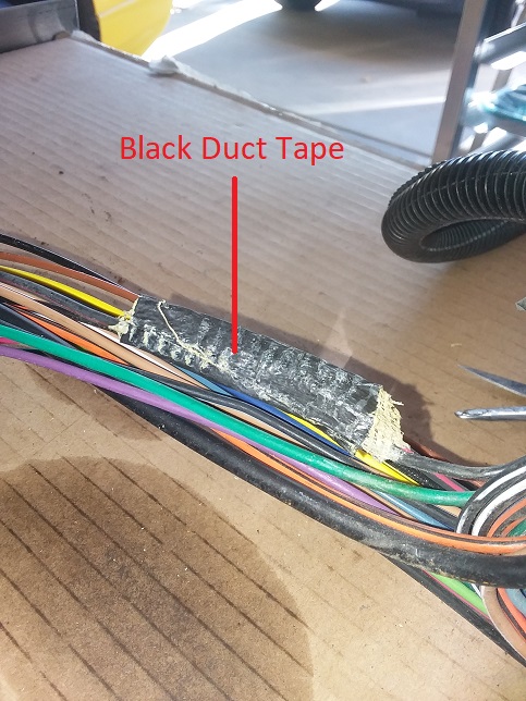

3) And here are the supporting pictures showing Defeat perhaps snatched from the jaws of Victory. There are at least 7 splices that I found hiding inside the conduit! These are covered in what appears to be black duct tape (suspiciously not OEM) but underneath they look professionally spliced and soldered. So my basic question is, did the 88 gt, 5spd, with A/C come with existing splices like this or has my harness been hacked? Keep in mind that all systems on the car function normally. At first I thought perhaps a prior owner was replacing damaged wires from some earlier incident but he would have had to use the correct OEM wires -- all of them match perfectly. Taking a closer look these splices are not eliminating a wire that was damaged b/c they do not terminate in another slice leading to two wires, they all go somewhere that looks OEM to me, like a sensor or a pin block. What has happened here???

Yes, there Are many splice in the engine bay and the rest of car. Most to All should S5xx numbers as shown in above pages I posted.
Example: should have several splices for injectors (4), ECM sensors (~4) and Cold start injector (1 or 2 depending just how the fusible link is installed.) Most links are splice then plastic molded cover. Rest of car would have problems w/ same plastic on splice in the harness. Plus cost more money for GM.
Splices are same type as FSM shows dealers how to slice.
If you want to follow all get 88 Fiero FSM or go to alldatadiy.com pay for a year or two.
Black tape on splice for ground mainly just protect others for any sharp edges. Other pic w/ more splices look normal but is a small pic... If looks bad on other splice w/ power thru them then fix covering or add more w/ Good Tape like 3M Super 33 or 88 electrical tape. 88 is thicker then 33 but same high resistance to UV rays, abrasion, moisture, alkalis, acids, corrosion and varying weather conditions etc. and rated heat 0 to 221 degrees F but still stay put even at higher and lower temps. Cheap tapes like HF and many others sell can fail very easy and quickly and many don't meet UL testing and other standards. (just ignore YT and other fools saying most or all E/tapes are same.)
Other black tape over the harness in some areas Is Not electrical tape. Is made for just that job as won't make a sticky mess. I think eastwood.com has/had right tape for this but not digging to find it right now.

That is such a relief it was GM and not a hacker ... thank you Ogre! I'll see if I can spot those splices in your diagram.

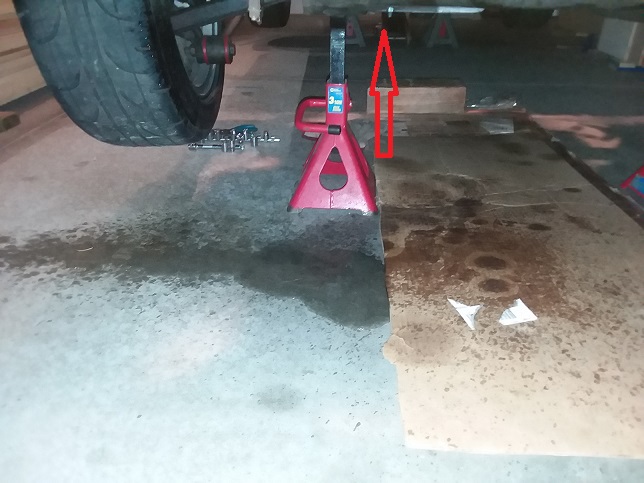

BAD: Connecting the coil the engine just sputters along a bit. Looking under the car I was amazed to see Water pouring out of the little vent/weep hole in the muffler.
Fearing a head gasket disaster I took all the plugs out. No sign of water and a slight gas smell. Taking a closer look at the 'water' I noticed it wasn't my 50:50 anti-freeze mix but clear water. Does this mean my fuel tank is full of water from standing 18 months??

There might be water in your tank, especially if your fuel had ethyl alcohol in it.
Alcohol will suck up water from the atmosphere.
In general, an engine won't run correctly on stale gas.
You may wish to dump some pure alcohol (methyl or ethyl) into the tank to get whatever water's in there mixed with the fuel.
Then, if your tank isn't currently full, you may wish to top it up with fresh fuel.
If your tank is already full, I guess you can burn off the fuel by driving the car the way it is, or you can transfer some junk fuel into another vehicle you own... then top up with fresh fuel.
You could drain a bit of oil from the sump to make sure that there's no coolant in the oil.[This message has been edited by pmbrunelle (edited 02-13-2020).]

Cold Exhaust get water and is it Normally and OEM mufflers often has a drain hole to deal w/ it. Should stop when The Exhaust is hot and may take some time in cold to very cold weather. Engine hot is not = to Exhaust is hot.
1% to 10% Ethanol in gas won't matter to water in the muffler or out thru tailpipe(s). "Real"/"Pure" gas can always do this. Water can condense and main source is a byproduct of the cat.
Year + old gas may have "Gone Stale." More so if Gas Cap is off/loose/bad etc. Just what do to depend how much gas in the tank. Under ~ ½ just add fresh 87 octane gas and wait until < ½ to ¼ before filling again. Full tank, siphon some out then do same. To get rid of rest of old, wait to burn the rest in engine then dump 1-3 gallons then rest fresh until gone. Dump gas on dirt etc is illegal in most places. If you suck out water watch putting old gas in to use.[This message has been edited by theogre (edited 02-14-2020).]
