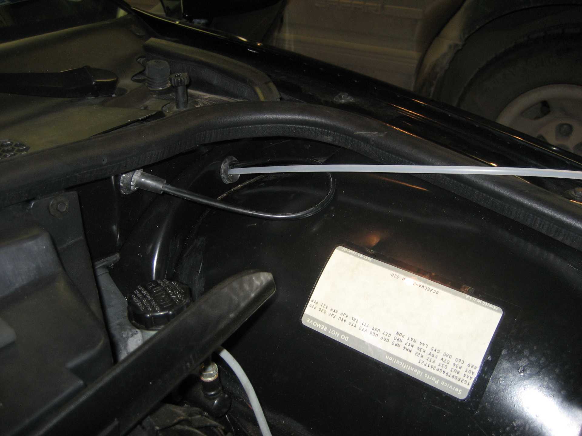

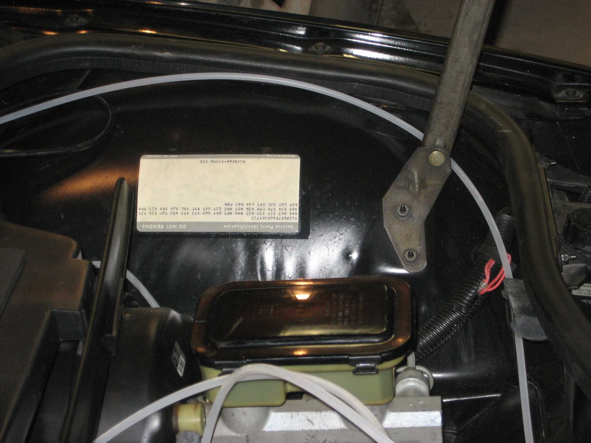

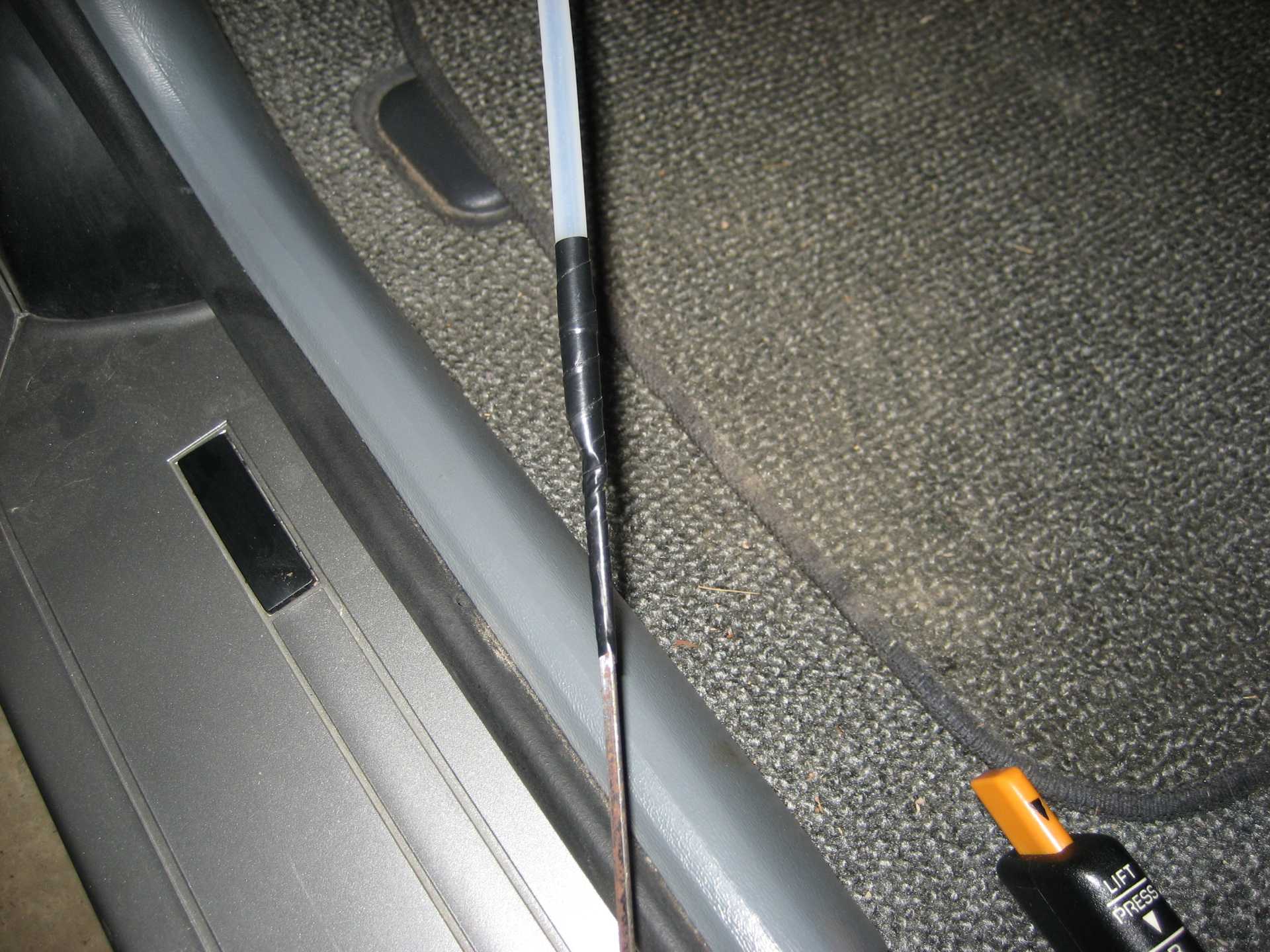

Hi guys, so I looked at what Cvxjet posted and liked the idea, but when I saw I would need to twist myself into a pretzel to do the job I decided to see if there was a way to get through the front firewall.
And I did, the hood release cable has a nice big grommet and its in the right place inside and out. I fished a nylon water line through to use as a conduit and it worked out pretty well. .
