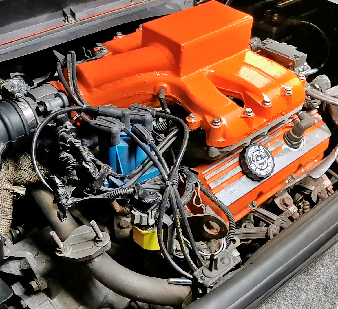

| quote | Originally posted by zobari: I have hired a welder (tig aluminium weld)
I have drawed lines where exactly he must cut and I told what I want like measure and shape...
Wait, you just gave him the stock manifold with some lines drawn on it and he did the cut-outs on the manifold, cut out all the pieces needed to make the box, etc., and then welded everything and he did all of that for only 180 euros??? Man you got an incredible deal!!
zobari
DEC 15, 12:09 AM
| quote | Originally posted by Notorio:
Wait, you just gave him the stock manifold with some lines drawn on it and he did the cut-outs on the manifold, cut out all the pieces needed to make the box, etc., and then welded everything and he did all of that for only 180 euros??? Man you got an incredible deal!!  |
Yes exactly. And it's a good welder and the price is low.[This message has been edited by zobari (edited 12-15-2019).]

zobari
JUN 10, 06:52 AM
I have modified my y pipe and remove restrictions (too much metal inside and the result that is decreased by 30% the volume before the downpipe).
with this upper intake and new y pipe, i can rev up to 6000 rpm without loss in performance. The engine breath et keep power in higher rpm better.
But before 3000 rpm not much difference than before.
Ok that's not a corvette of course but a bit power and better rpm extension is good for me with this 2.8, i'm satisfied with these mods.
If you want see the final result in the engine bay :
video modded intake and ypipe fiero engine bay[This message has been edited by zobari (edited 06-10-2020).]
La fiera
JUN 10, 01:00 PM
JUN 10, 03:28 PM
Very nice job... but get some shielding or exhaust wrap on that Y-pipe before you cook your ignition coil and ICM !
zobari
JUN 10, 04:14 PM
Hi Patrick,
Yes I have Aluminium sheet that I will cut and in order to protect the ignition coil and distributor. I will make my own sheet shield this week.
I have seen it one year ago but thank you for your advice.
