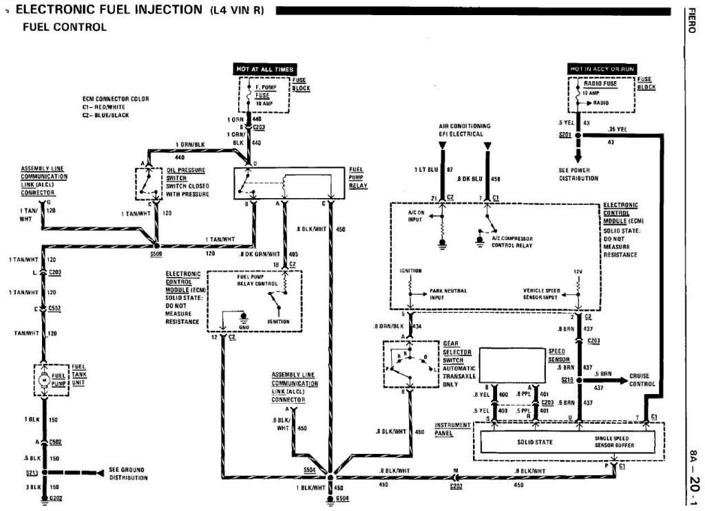

You don't have the exact same situation. Temporarily run 12V power direct to fuel pump connector. If test light/voltmeter shows pump is getting 12V power even as PSI drops to zero - it has to be the fuel pump.
From 1986 Factory Service Manual... A picture is worth 1000 words.

so, if I were to run a wire from the switched "ON" terminal at the fuse box to the ALCL . the pump would HAVE TO run all the time. and if the pump DID" stop" running,(or stop providing pressure) it would HAVE TO BE the pump itself, correct ?
SEP 08, 11:41 PM
quote | Originally posted by Lou6t4gto:
so, if I were to run a wire from the switched "ON" terminal at the fuse box to the ALCL...
You've got a 12v source at the cig lighter right by the ALDL port to supply what you need... for test purposes only of course.
... the pump would HAVE TO run all the time. and if the pump DID" stop" running,(or stop providing pressure) it would HAVE TO BE the pump itself, correct ?[
Correct. The ALDL fuel pump terminal is connected directly to the fuel pump.[This message has been edited by Patrick (edited 09-08-2019).]

I NOW HAVE a wire coming from the lighter hot, out to the console, and a wire from the fuel pump plug at the acl out onto the console. not connected, (Just in case) .I took it for a few mile ride, acted just fine ! Maybe just the "threat" of being hotwired Scared It ! LOL
