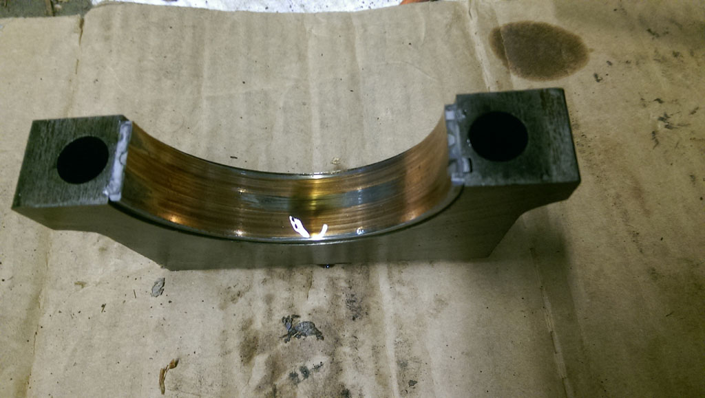

JAN 23, 08:55 PM
Here is a pic
bad bearings?
pmbrunelle
JAN 23, 09:22 PM
Has this bearing been wiped dry? Is the brown color oil, or is it the bearing itself?
Madess
JAN 23, 09:36 PM
The golden color in the very middle is oil, the copper color that runs all the way across is the bearing.
Will
JAN 23, 09:41 PM
It's worn down to the copper. Those were toast a LONG time ago.
How does the crank look?
Edit: you can even see more copper under each cylinder, where the pressure spikes as the piston is near TDC. Done.[This message has been edited by Will (edited 01-23-2018).]
Lou6t4gto
FEB 12, 01:50 PM
no doubt the crank looks like that also. run your fingernail on it, it should be PERFECTLY SMOOTH.
Blacktree
FEB 12, 02:24 PM
That main bearing is definitely worn. So at the very least, the main and rod bearings should be replaced. But I don't think that explains the chunks of metal in the oil pan. Maybe it chewed up a rod bearing? [This message has been edited by Blacktree (edited 02-12-2018).]
Will
FEB 12, 09:28 PM
| quote | Originally posted by Lou6t4gto:
no doubt the crank looks like that also. run your fingernail on it, it should be PERFECTLY SMOOTH. |
I've seen rod bearings come out looking like that and worse, while the crank was pristine. New set of bearings and the engine was fine. That's why bearings are SOFT... so that they save the crank.
