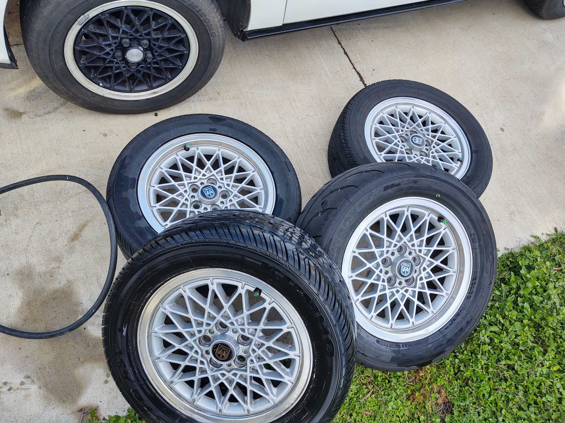

I ran across a set of the offset rims that are off a formula (I would assume) These rims are cross laced rims but are silver! I can see in one small area that rims have an very light grey to silver finish bit all the cross laced rims area it is all silver. I have never seen offset rims in this color before and no one I have asked has either. Did they make silver cross laced offset rims? What else could these be from? Thanks Pat

The clincher is the position of the valve stem. Those are most certainly 88 wheels. (Well... obviously the fronts are.) But the earlier lace wheels have the valve stems at the point of the spokes, as opposed to the "flat" area between two spokes, like these.
Wonder if someone had them stripped and powder coated. Do they still have the clear coat over the machined, unpainted portion of the rim?[This message has been edited by Raydar (edited 10-23-2021).]

The 88 15x6 front wheels were also used on another FWD Pontiac. I think Grand Am/Sunbird or something like that.

I believe you are unlikely to find a set of non-OEM wheels that have the correct offsets. Least ways not in the affordable category. They can be had, but you're getting into custom territory and ca-ching ca-ching. I had my OEM wheels refurbished. I chose black powder coat over the original gold. The rim face was turned on a lathe. They are almost exactly like what brand new OEM wheels would be. I wanted the face of the honey comb spokes turned down to bare aluminum also, but the shop said they couldn't do that since they weren't that way originally. Whatever, I can't force them to do it. Anyhow, I like my refurbished OEM wheels. I recommend you consider doing the same. ------------------ Stanton '88 Formula, red on gray

1. This thread is 4.5 years old. 2. They are 1988 GT/Formula wheels with the original black/gold paint stripped off the webbing.[This message has been edited by Skybax (edited 10-24-2021).]
