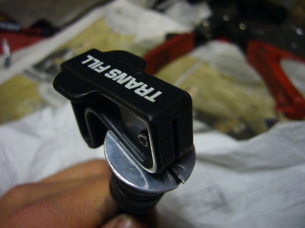

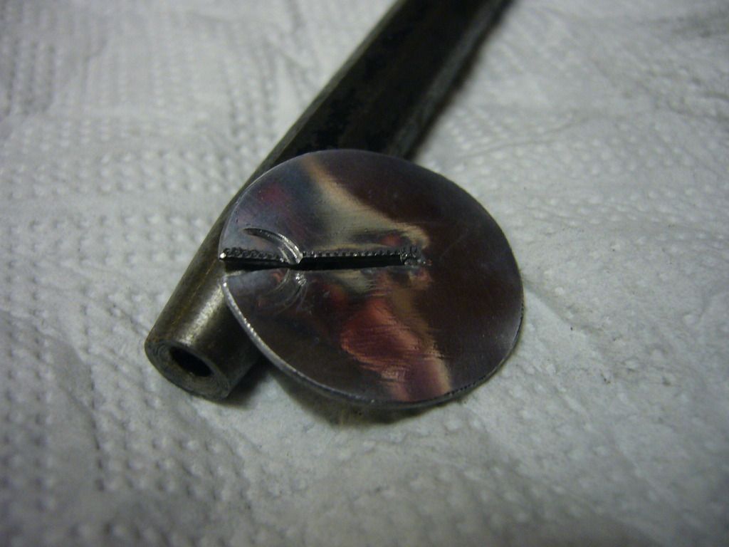

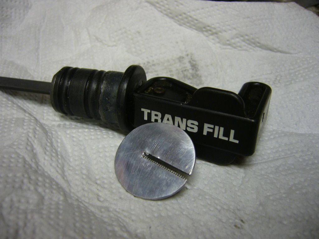

Small update - Flip up dip stick repair:
Yesterday I´ve had some time and fixed the sloppy flip up dip stick in a quarter-hour:
Made out of 0.8 mm aluminum sheet metal.
Now the flip up dip stick sits tight and seals again.
Also a cheap and easy fix!
(I haven´t found any bread bag plastic clips here in Austria)
[This message has been edited by Moar (edited 10-28-2015).]
