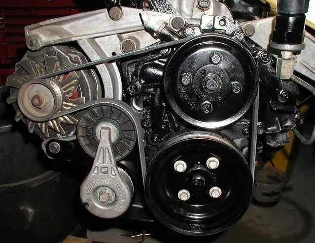

If you're referring to the serpentine belt on a 2.8... This is the solution.
reinhart
MAY 31, 08:05 AM
More importantly than eliminating the squeel (at least to me) is with the auto tensioner, one doesn't have to worry about over tightening the belt and ruining the water pump (or alternator). I always kept my belt a little under tightened just to be safe after a water pump went out due toa mechanic overtightening the belt to stop the squeel..
