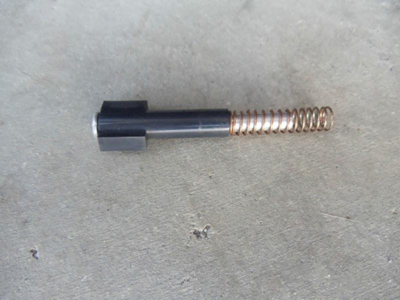

Wheels with a center button style horn use a captive plunger. The spring pushes the "nail" or plunger up against
a metal plate in the underside of the horn button. When the horn button is depressed the metal plate contacts the
horn latch clips and provides a ground path through the column to activate the horn relay.

ArthurPeale AUG 25, 06:09 PM
No, it's definitely assembled correctly. That's not the issue.
the issue is the lack of continuity between the wheel and the spindle into which it is inserted.
using a meter, with one probe on the center nut, and the other on the part on which the button clasps, there should be continuity - there's not.
My best guess is the thin layer of grease I applied to the shaft - it may be insulating. Unless there's another thing preventing continuity that I missed during reassembly.
ArthurPeale AUG 26, 09:39 AM
As a cludge repair I shoved a ball of aluminum foil in the space between the wheel and where the wheel nut sits.
It works...but I'm not happy about it.
I'm not wondering if I missed a part when I was assembling that would have done it on its own.
