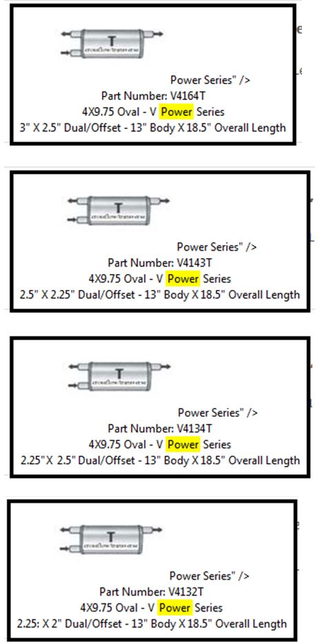

Good question. I have the Flowtech Afterburner with cat. convertor AND resonator tips. This one: https://www.summitracing.co...t/parts/big-50363flt Sounds very good outside, but the drone INSIDE downs out the exhaust note between 2500-3500rpm.
Super annoying, can't enjoy radio etc. and why I'm rebuilding my exhaust. A friend put the same Afterburner on his Fiero 3800 s/c after I warned him not to. Super loud.. but he "got used to it"... (..."can you repeat what you said?" lol)
I ordered the Jones V4143T muffler for my Indy SD4 from eBay - 13" case length... (I gave up on Mandrel Bending Solutions after a week of pizzing about with them...)
The Jones Exhaust V4132T would be closest to factory muffler

The Jones V4143T V-Power muffler I ordered arrived today. https://www.jegs.com/i/Jone.../523/V4143T/10002/-1
It appears to be very well constructed. Pipe connections are 16ga. It is supposed to be quieter than the Jones Deflector muffler (comparable to Flowmaster 40 or 44).
The "guts" of the V-power mufflers are all the same. I photo-edited this cutaway to show how it looks as a transverse. No flat surfaces or sharp corners inside, so supposed to be deep tone without drone/resonance. Yup - you can see light right through between the outlets.
