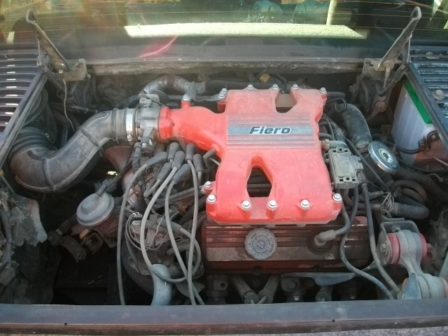

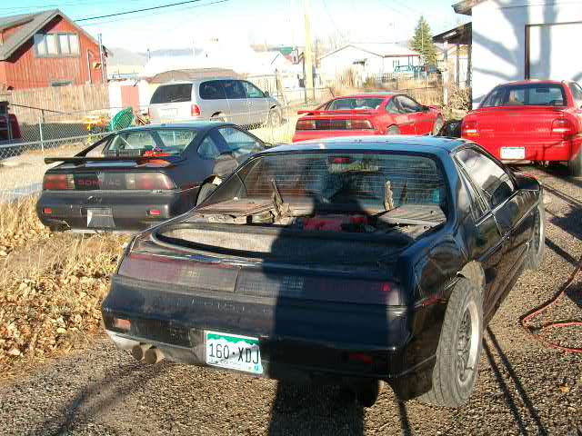

Here are some pics.
The first two are of the victim. Nevermind the missing decklid, it is in the garage curing after a fresh painting.

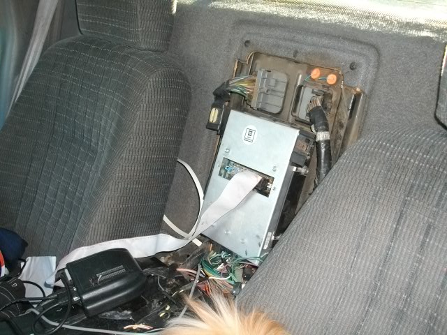

As one can see, the ecu is installed in the stock location in the stock ecm tray. I have the autoprom running the show right now while I am changing code quite frequently.

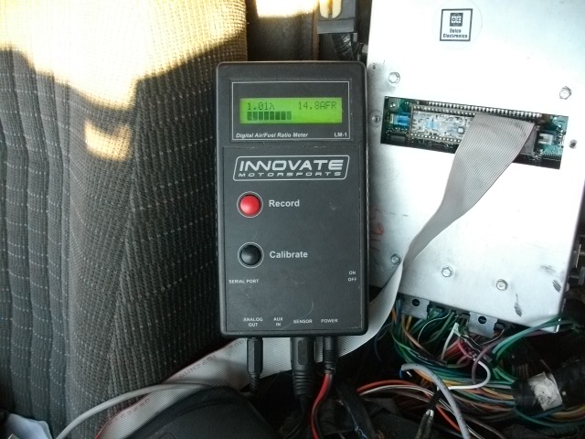

Just to show that the wideband is functional. I have a different WBO2 controller that will be installed in the ecu case and will use the stock connectors, just need to run a few extra wires. I do have this computer running the cooling fan by the way.

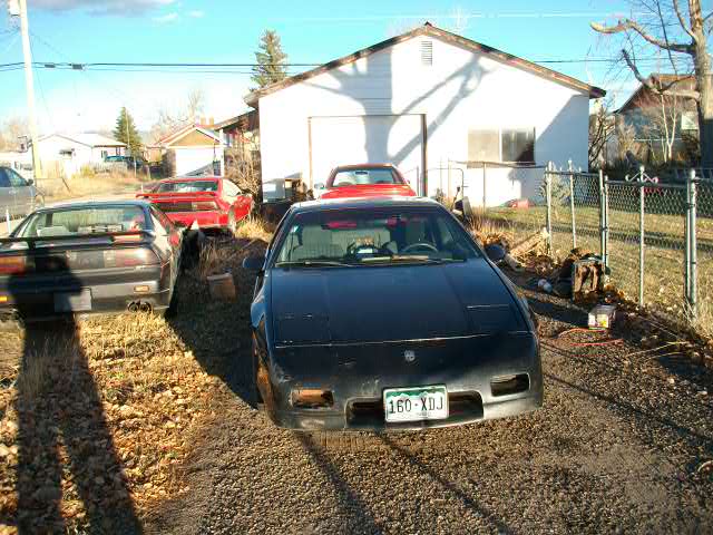

Just for the doubters out there. Your average 2.8 V6 stock, no mods with a 4 speed muncie.
