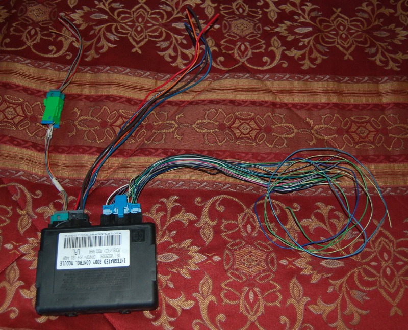

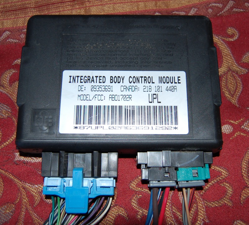

After reading your site, I thought that since my car is already apart, this would be an awesome time to upgrade. After a quick check, my local Pick and Pull had a 2002 Camaro that had been added to the yard about 3 weeks ago. So I went over to see, and sure enough the module was still there. It is located in the same place as the Firebird unit, just where you said it would be
I pulled it, all of the connectors and as much cable as I could get:
My only concern is that the Camaro took a good pop to the front end, both airbags deployed and the engine was eating the radiator
Total cost was $53
Thanks for sharing this with us! I can't wait to get it put back together.

fieroluke
OCT 18, 03:06 PM
Thanks for the compliment, Jerry!
Was the BCM hard to yank out?
I don't think the BCM would be damaged in a crash. I'm also very much looking forward to upgrading my yellow baby! If only it was summer again...

Yellow88GT
OCT 18, 07:53 PM
| quote | Originally posted by fieroluke:
It required a stout tug to get it out of the cradle it is in. There are not any locking tabs holding it in the cradle. Only the squared off parts of the module's edges seem to hold it in place. The cradle is made of fairly flexible plastic, I was going to attempt to remove the cradle, but it appears to be molded into the larger under dash assembly.
If you don't mind me asking, how did you end up securing the BCM under you dash?
Thanks,
Jerry[This message has been edited by Yellow88GT (edited 10-18-2010).]
fieroluke
OCT 19, 09:34 AM
Hi Jerry,
I didn't secure it much at all. The Fiero wires are a lot thicker than the original F-body wires. As a result, the three connectors and harnesses are pretty stiff when taped. The harnesses come from the passenger side, and I let them run towards the driver side A-pillar, then make a 180 degree turn towards the passenger side, and then 90 degree "up". The harnesses, when taped, act sort of like a spring, and I had to push the BCM down along the front firewall to mount the dash. I've had the GM VSS-201 remote unlock receiver in this location without securing it for over 10 years, and never had a problem...
As you've seen, GM didn't secure the BCM much in the f-body either, so I guess it'll be fine where it is...------------------ Visit my website: www.fieros.de for lots of technical and other Fiero related information Maroon 87 GT daily driver with Firebird Body Control Module, Power Window Controllers and Dash mounted Scantool/Trip Computer
