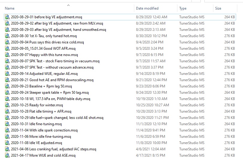

I began tracking my changes at the end of last summer by saving "milestone tunes" (not necessarily every little micro-change or quick test) with descriptive file names. TunerStudio also has a file comparison function, which is handy.
Unfortunately, I haven't been documenting my reasons for each change; I only have records of the changes themselves.
I don't remember from tuning the afterstart enrichment last year if more enrichment had no effect (except wasting fuel), or if more enrichment caused driveability problems. So I'll just have to wait and see what happens in the fall.
