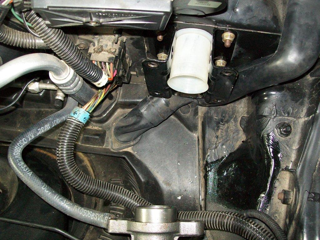

Here is a shot from above with the old booster removed.The shiny black area is where the sheetmetal needs to be adjusted to fit the larger booster.

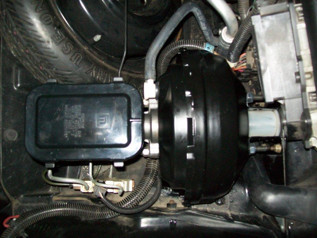

Here is the new booster installed. There were no fitment problems.

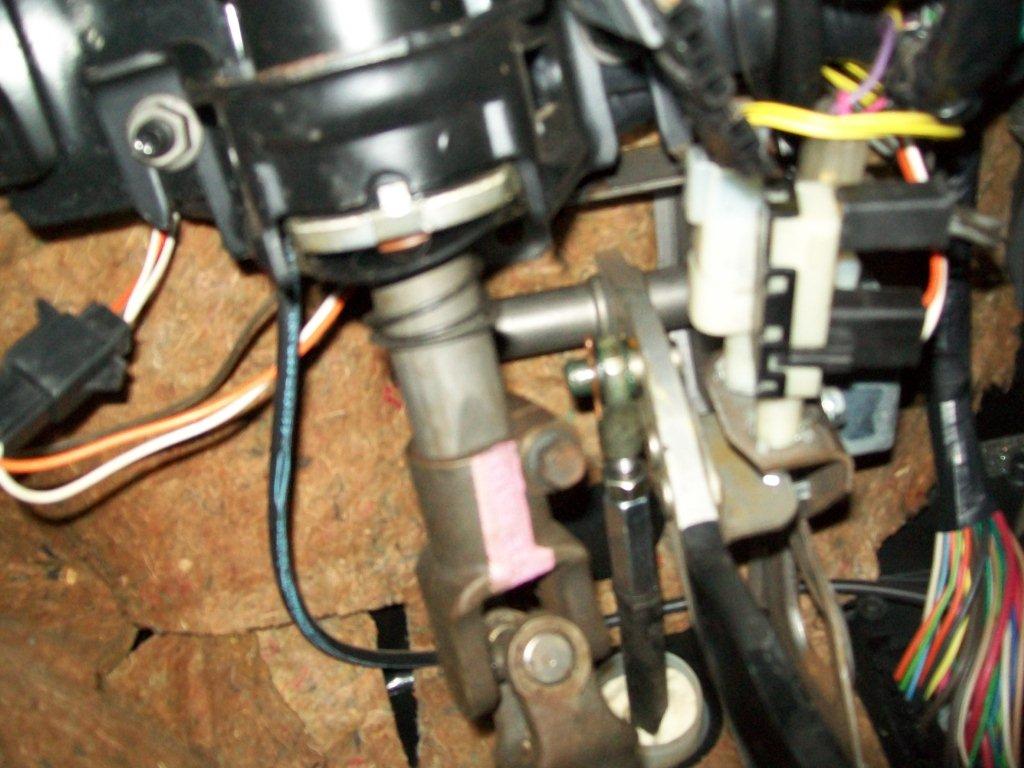

All that was left was to adjust and attach the pedal rod.Measuring from the booster back body to the center of the rod end hole, I found that 9 3/8" was about right (as found by other members) but fine tuning can be done with the threaded connections if needed.

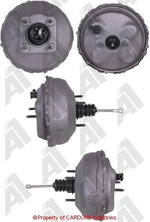

You will enjoy that upgrade! It really gives a lot of bang for the buck. I like the look of the thicker pushrod too, even if it is overkill.For anybody who might be interested, I looked up the booster I installed using the application data from Summit and found this at A!-Cardone - part #54-71046.
It's for a 1993 Blazer.This looks like the one needed for the booster upgrade too,and it has a longer pushrod which would make modifying it a bit easier.[This message has been edited by 85GT_3800SC (edited 02-20-2012).]
