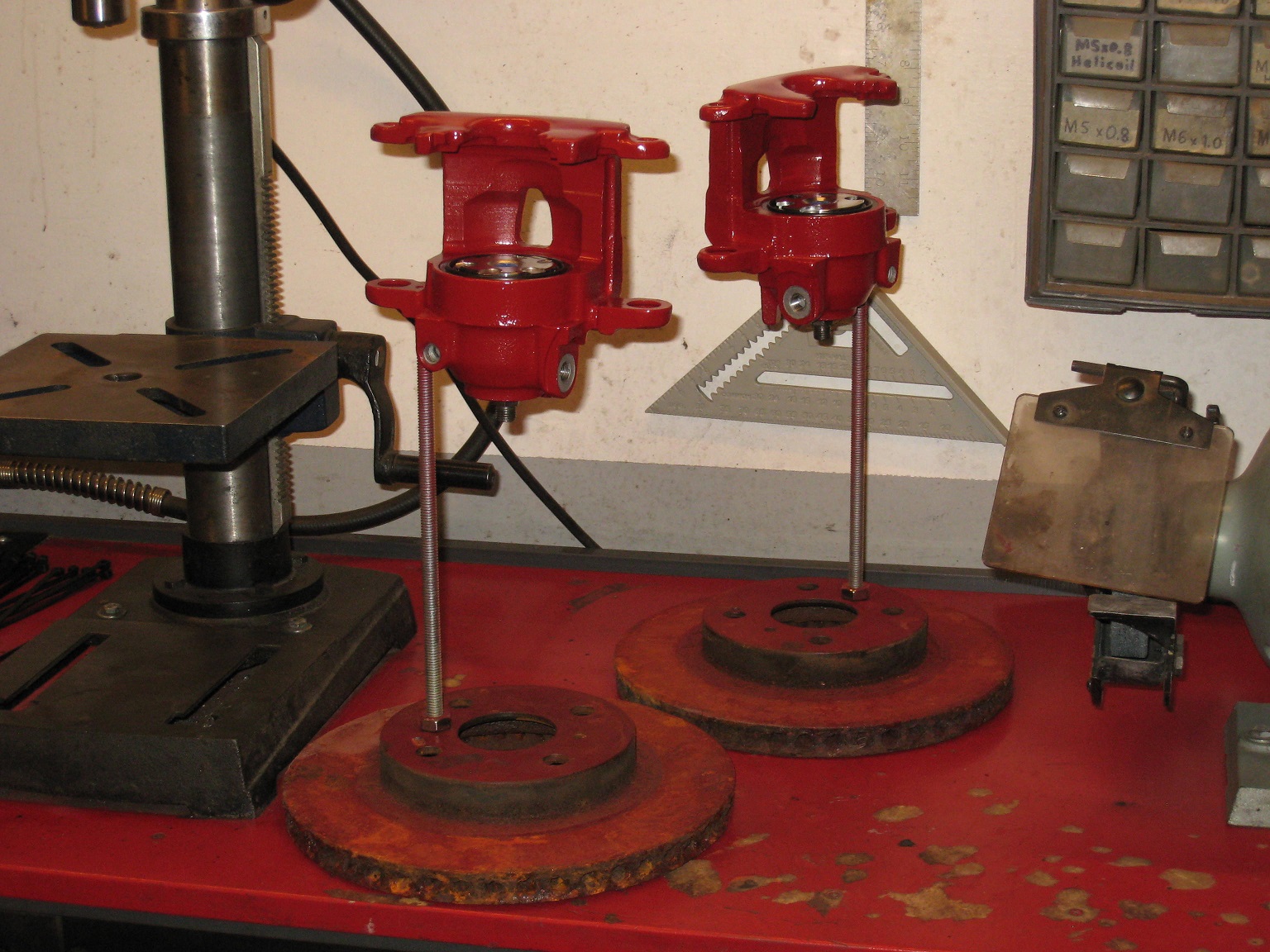

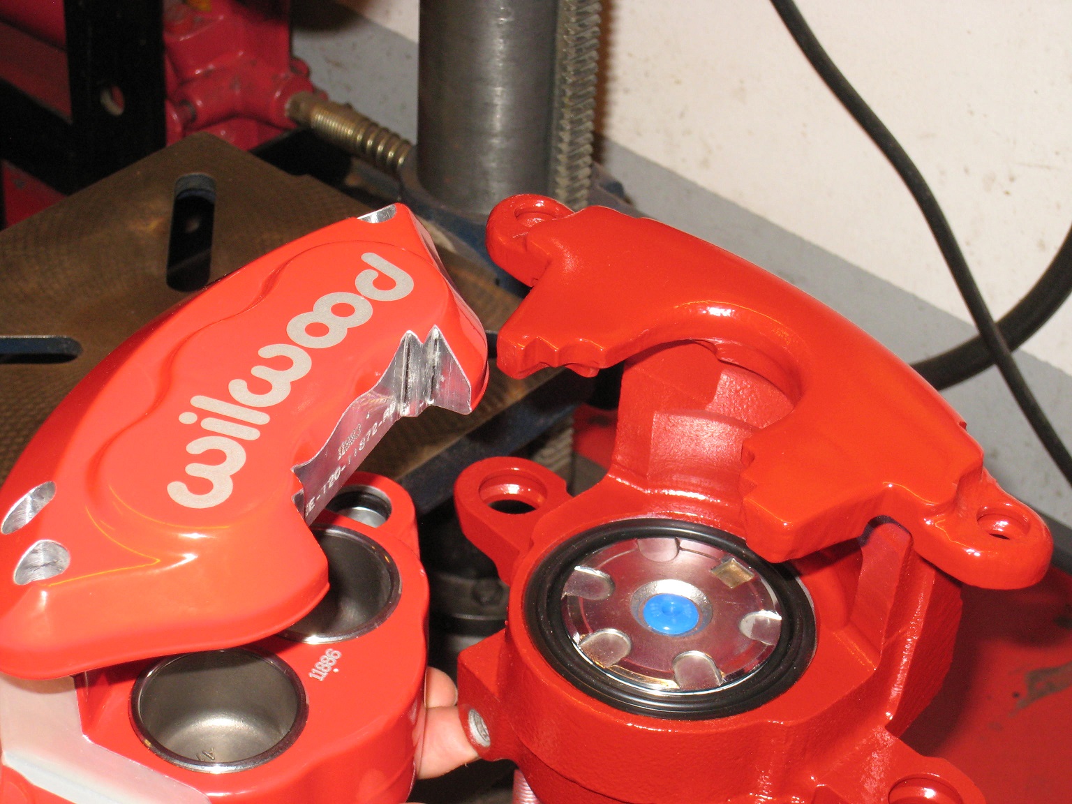

My rear Cadillac Seville calipers are pretty much complete now.
After cleaning out the rusty sludge inside, I modified the calipers to use banjo bolt bleeders: http://www.fiero.nl/forum/Forum2/HTML/144809.html
I honed the bores to remove any corrosion. Then, I sandblasted the exterior.
I applied silicone grease (Kleen-Flo Eze-Slide) to the bores to reduce future corrosion, and to aid in assembly. The pistons were then inserted with a C-clamp. One piston had to be replaced, as I found brake fluid behind the vent hole.
After masking the calipers, and setting them on makeshift "paint stands", I painted them with red spray-can VHT caliper paint.
The shade of the VHT is darker than that of the Wilwood caliper, but it is acceptable (for now).
I will wait perhaps two weeks, then I will bake the calipers 1 hour at 200 °F in the oven, as per VHT instructions.
