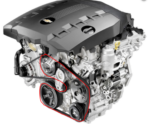

Msweldon & RandomTask, I really haven't worked out the coolant routing yet. As for the engine mounting and related issues, I blocked the engine/transmission in place and moved it around until I liked the position. With the power steering pump removed and a shorter belt in place, it all just seemed to fall into place. I'm not familiar with the Camaro LFX. I went with the Impala motor because it seemed there would be fewer issues using a transverse engine. Hope you guys continue to chime in. The feedback and suggestions are appreciated. Daryl |

So you're tracking, on the Camaro LFX, the power steering pump and alternator are switched as to what they are on the Impala. (Fun fact, in GM's infinite wisdom on the Camaro PS Pump, they put a bolt that disconnects the pump right behind the outer edge of the pulley; you have to take the pulley off to get the pump off the block). Since we don't need the PS pump, that leaves the Camaro LFX in a little of a predicament, I can't run straight from the AC to the water pump b/c the tensioner is in the way. My options are to either keep the alternator where it is and fabricate a PS delete pulley setup, or just buy an Impala alternator and install it (where the Camaro PS pump used to be).
The only thing I'd be worried about in the picture above is the amount of belt wrap I'd be putting on the alternator. The impala setup has an idler pully right next to it to increase the purchase. While we won't be driving the alternator anywhere near as hard as an impala (since we have way less electrical needs) it's still a concern. For piece of mind, I'm on the lookout for the bolt/washer setup for this idler pulley.[This message has been edited by RandomTask (edited 01-09-2020).]
