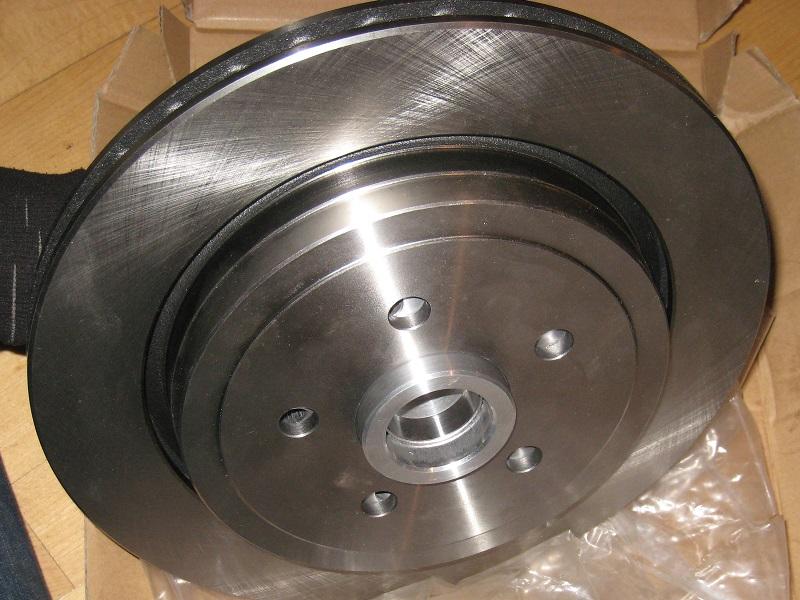

The LeBaron rear rotor centrebore lies somewhere between a Fiero rotor centrebore and a Fiero wheel centrebore.
Therefore, it is not compatible with stock Fiero hubs.

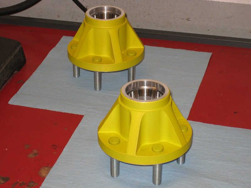

Up front, I simply used some $$$ to order some sluppy123 7075 aluminium hubs. Brian makes the hub to fit the centrebore of your chosen rotor.
The hubs were almost perfect, though the fit between the pilot and the centrebore was a bit tight for my tastes, so I pressed out the studs, turned down that diameter a hair, and then re-installed the studs.
I painted the backside of the hubs with yellow zinc chromate primer.
Typically, Brian powder coats most of the exterior surfaces black, but my personal preference is to have no powder coating in a bolted joint (i.e. in the wheel-brake-hub stack). Brian left these hubs bare so I could finish them as I pleased.
I'm quite satisfied with these hubs. They didn't require any deburring, and Brian is good at answering questions.
The rear hubs were a simpler affair.
I just pressed out the studs, turned down the rotor pilot slightly (to fit the LeBaron rotor), and I re-installed new studs.
The Dorman 610-323 studs at all four corners are pretty long, so I'll have to use open-ended lug nuts.
That's OK, if I ever want to take this car to the racetrack (tech inspection), having the studs stick out beyond the lug nuts will allow anyone to quickly determine that my lug nuts have sufficient thread engagement.

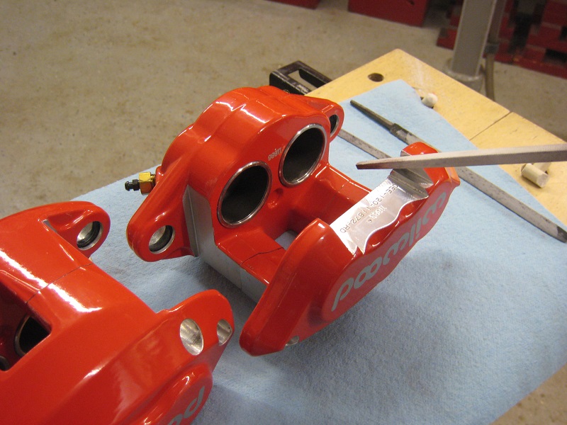

On the subject of weight, I did get some Wilwood aluminium calipers for the front; they seem lighter than the cast iron calipers.
I began with the 2.125" parking-brake rear Seville calipers as a "given", so these Wilwoods were the closest match I could find in terms of piston area. I was looking for the same piston area front and rear, or maybe just a little bit bigger up front. I also wanted to be compatible with stock Fiero brake hoses, and have bleeders that would work.
Apparently Wilwood doesn't deburr their stuff, so I had to go at these brand-new calipers with a file.
Forum member wftb uses these same calipers.[This message has been edited by pmbrunelle (edited 02-18-2021).]
