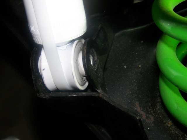

I had my brackets made by a local machinist using the drawings posted earlier. Here is how I solved the shock clearance problem. Sorry if some of the pictures are a little dark
Here is where the shock normally mounts
 This is where it needs to be moved back to for clearance of the banjo bolt.

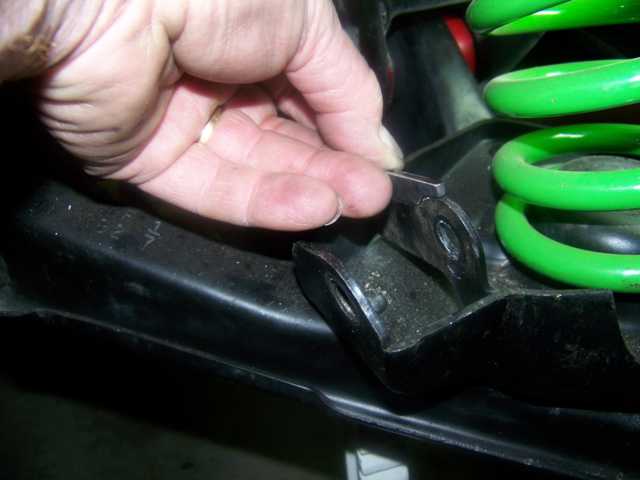

The rear mounting flange has room to drill a new hole. The front flange needed this piece to be welded in place.
 This is where I welded the small piece and then drilled new mounting holes.

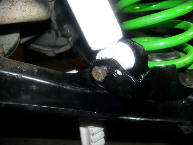

Here is the new position with the bolt in the hole. Now there is no clearance issue at full lock even with wheel off the ground.
