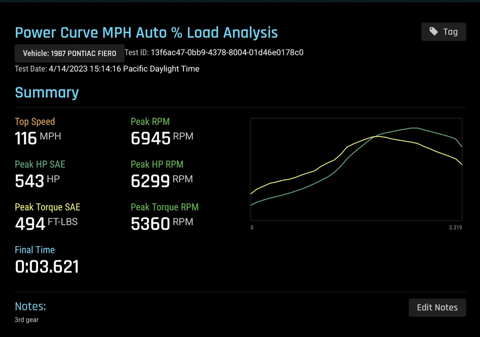

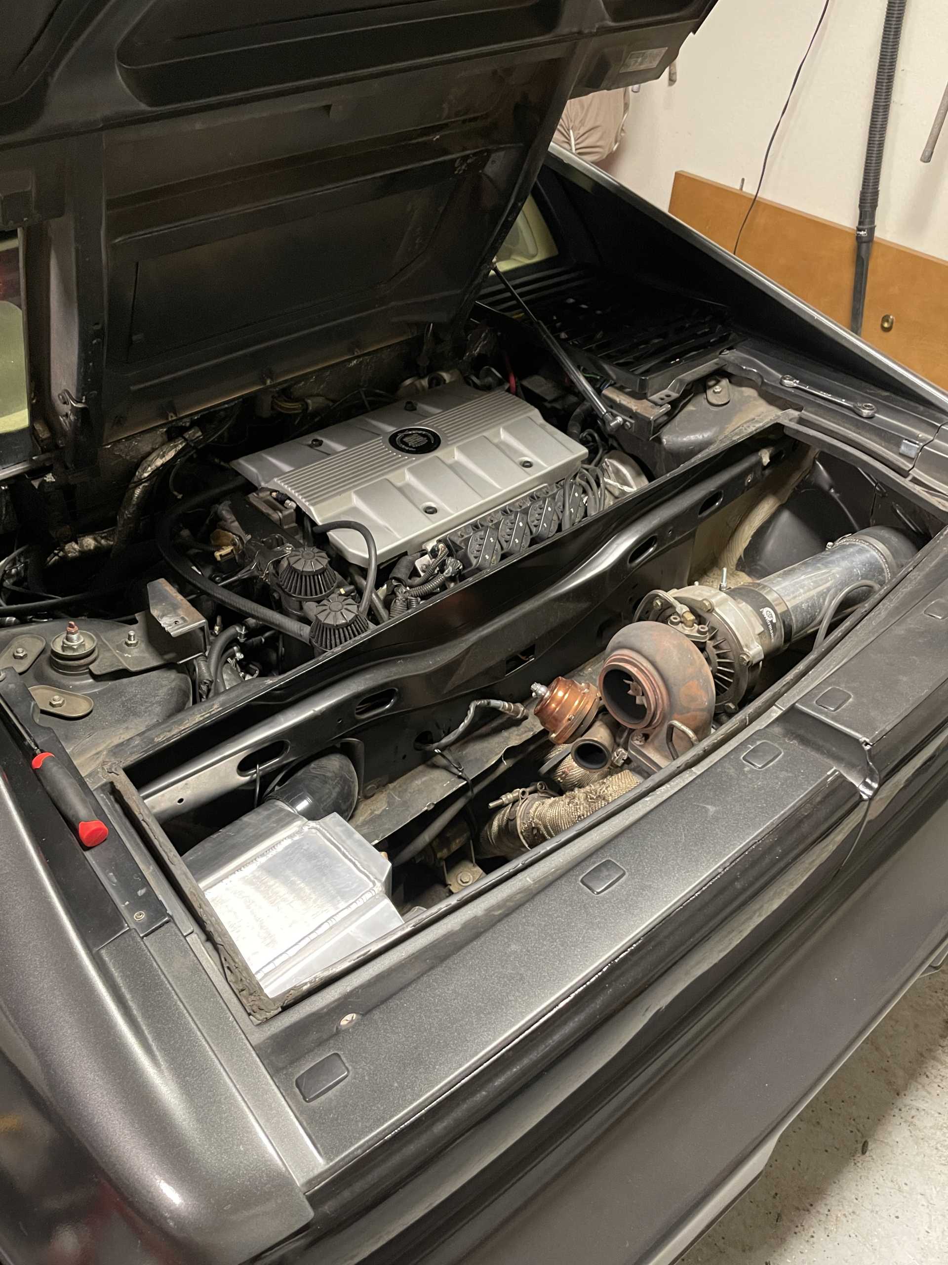

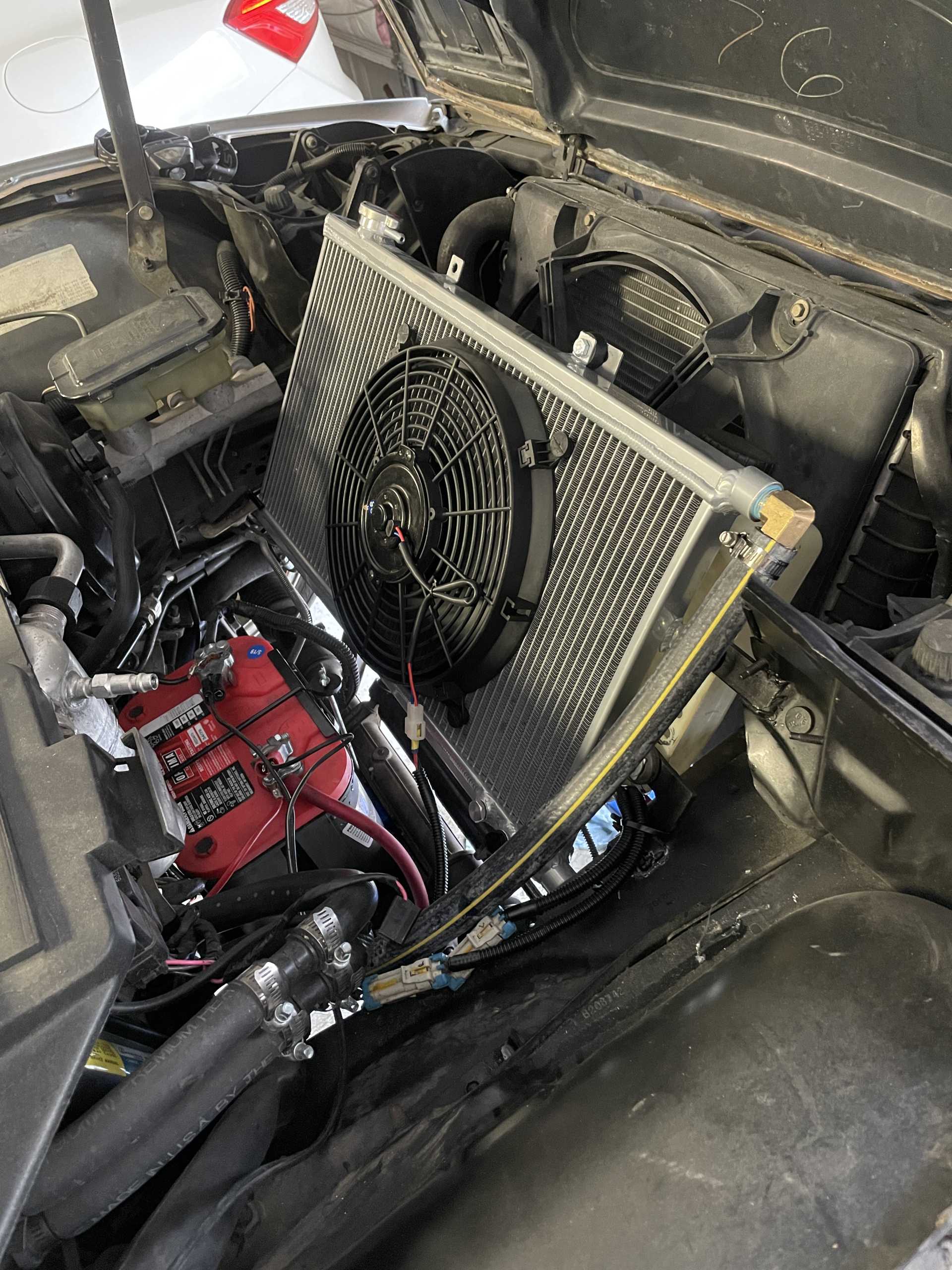

Hey guys, just wanted to give an update since it's been several years. I guess at some point I found direction and just took off. Not sure if I mentioned but I ended up picking up a 87GT Chassis.
As the build sits it is a .020 over northstar with a 70mm turbo, F40 6speed, water injection, and water to air intercooler.
I'm making just over 540hp at the wheels but need to go to a standalone ECU to crank out more power.
The engine has Ross Racing pistons, and Eagle H beam rods, and King Tri metal bearings. Professionally hand balanced entire rotating assembly. Running royal purple 5w-30XPR with an oil cooler and K&N filter.
Walbro 450 fuel pump and 1000cc injectors. running about 20psi of boost. Norms inserts with ARP studs and cometic gaskets. I have also had the A/C working at one point.
The wheels are grandsport replicas with 345s in the rear 285s up front TOYO R888. Brembo brakes from a hyundai 5.0 and corvette rotors.
I have also converted to adjustable electric power steering which has been just awesome.
I believe with a proper computer this could get in the 700hp-1000hp range. The MAF is maxed out and cannot convert to speed density with the LS1 northstar program from westers.
Currently I have the car listed for sale as it has really been sitting the last few years as i pursue other paths. Thank you guys for all your help.

What flares did you use?
Where did you have the block honed after it was bored?
Is the new radiator your intercooler?[This message has been edited by Will (edited 06-27-2023).]
