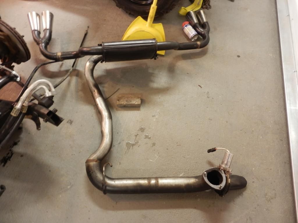

Mines an 88GT. Hmm, maybe you could make two sets of the coolant tubes? I really don't like all that rubber hose under my car. And I still need to replace the exhaust. The exhaust Dean built for my car is pathetic. I have repaired, or replaced so much of what he done it makes me sick. Anyway, if you look at the link below, this is exactly how I want to do my exhaust. I pm'd the guy about duplicating the exhaust from the catback but he hasn't responded.

Here is the crap Dean built! So much for a custom 3" exhaust!

Joseph Upson APR 07, 06:38 AM
I wouldn't want my electric exhaust cutout anywhere near me, even located aft center of the car it is loud and several times more with the throttle wide open. It's not easy in such a small space to have a good muffled system that also has sufficient flow. When I added the exhaust cutout boost pressure went up 3+ psi upon opening it all else the same. The car felt fine but it took adding the cutout to realize how much it was bottled up.
BV MotorSports APR 07, 05:43 PM
TBH, with the turbo it doesn't really get much louder when its open. You get more turbo whistle, and thats about it. Hopefully, I can get the 3" exhaust sorted to where I wont need the cut out. But, I have it, I may just use it anyway.
Joseph Upson APR 07, 06:28 PM
I've read that a number of times and I'm not sure what your idea of loud is but the only quiet turbo car I've owned was my twin turbo IROC Z and it had a long exhaust to make that possible. The only way I would drive through my neighborhood with my exhaust cutout open at 5 a.m. in the morning is if it was stuck open and I'm sure I have turbo whistle, I just can't hear it very well over the exhaust note which is a little bassy. No idea of what TBH means but I understand why my preceptor chewed me out for using acronyms in notes and discussions.
