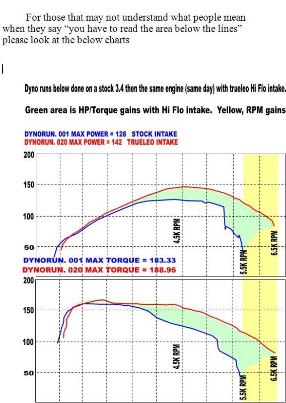

Francis T MAY 23, 09:05 PM
Something is really off that's too rich and your power is too low for those mods. the run bellow was done on an almost stock 3.4 and you can see the mid and top-end gains. It could be something as simple as a faulty MAT sensor screwing up your A/F ratio. I've seen on do that on our wideband. Try putting a stock chip back in and driving it. The dyno run below was made with a stock chip it will let you rev it past 5.5K.
I did make more power with the Fiero ECM, but at the same time I put on your intake, I did a '7730 + DIS conversion. So I finally bought a burner and am doing some of my own tuning and reading alot. I've already burned myself a chip to improve that but the car will be out of commission for a few weeks (story of my life)...
lou_dias JUL 08, 08:14 PM
Well, after buying a chip burner from Moates.net and using Tuner Pro RT to do my own tuning, I believe I've gotten alot of horsepower back. I also used some octane booster additive and the car runs much better when hot now as well.
