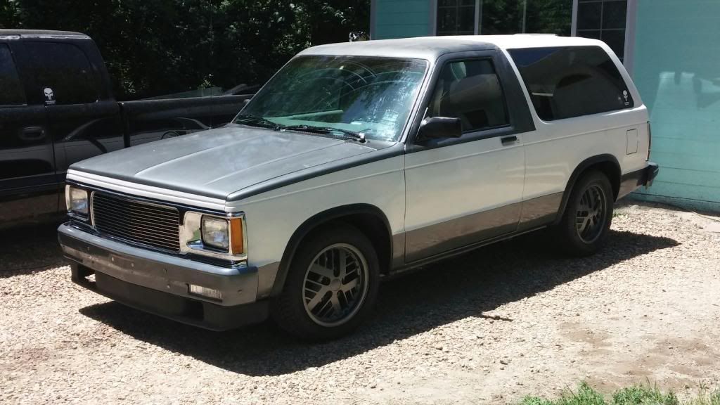

Greg Z JUN 15, 09:10 PM
Truck with its new wheels and great stance
Greg Z JUN 16, 02:48 PM
Here's another shot Joe sent me of the truck. Now has a damn good looking stance to it. Looks ready for the road :-)

motoracer838 JUN 16, 03:18 PM
Originally posted by Greg Z:
UPDATE: heres a few pictures of the project truck. i went by today and he says he wil start on it monday. i'm determined to build this GMC Hauler.
I pulled this post up to show the change in "elevation".
I see a light at the end of the tunnel, and for once it's not a frackin' train... Joe
