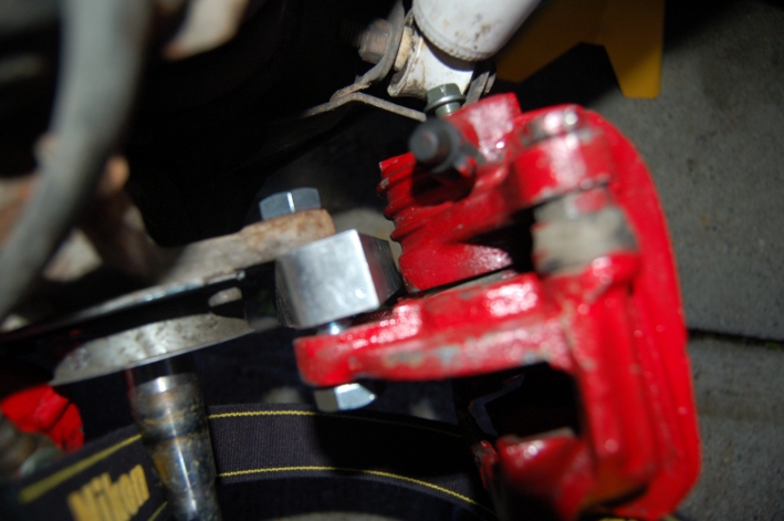

Well here I go I installed the corvette 12" front brakes but am having issues with the banjo bolt hitting th front shock as described by other on this post. I tried rotating the calipers from side to side so that the bleed screw is facing up? Tried the brackets every way I can think of but am still unable to get the banjo bolt to clear the shock with the tire off. Does anyone have a picture of the caliper mounted with out the rotor in place so I can see the bracket alignment. or a view from the back. Obvious that I am just assembling it wrong but can't seem to figure this out. I even tried the caliper mount bracket on both side to no avail. Anyhow thanks in advance.

my only concern with it freeing up under load is that cornering in a situation with under load then losing the load could cause damage to the caliper. I am sure I am just missing something.
I tired all the combos I could see. Anyhow mabe I will take a pic or two and post them so you can see what I mean.

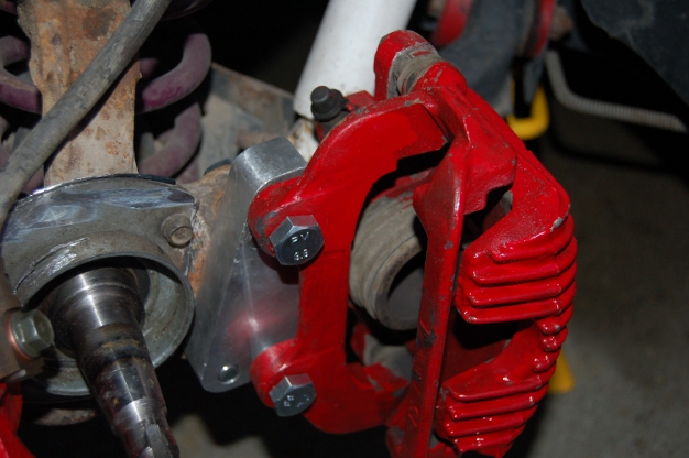

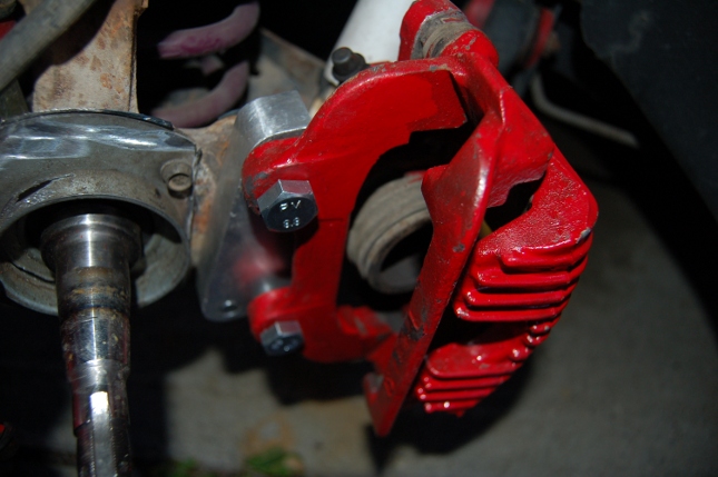

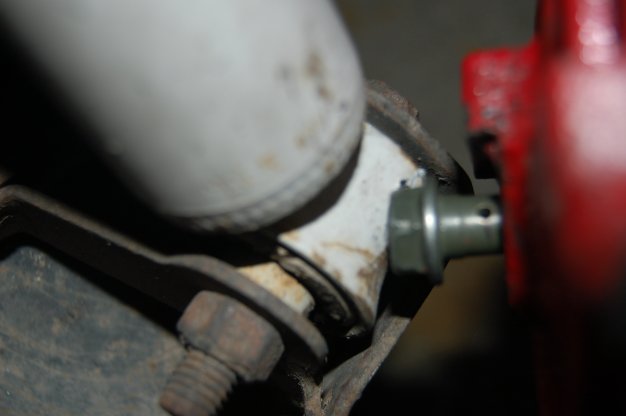

The brackets I had made at my local machine shop. He did an excellent job. Everything lines up but as I said before the bolt ie back of caliper hits the lower shock bolt.
Shianne AUG 12, 11:34 PM
well here are some driver side pics with the banjo bolt shown against the shock. I also include a pic of the bracket. Give me some ideas what I have done wrong with the below.
note how that bolt is touching the shock. The car is not at full turn radius.

hmm, it looks like you have it installed the same way as the other guys that have done this already... maybe someone else that has done it already can chime in and help.
