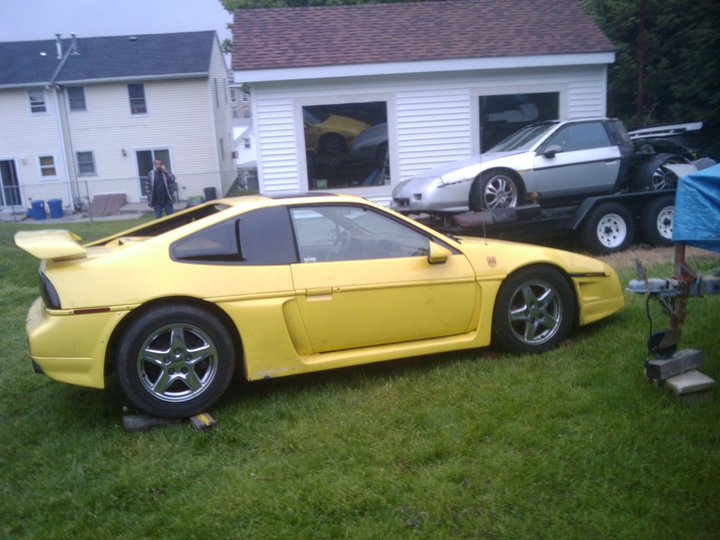

I have now transferred the interior and exterior from the USELESS 4.9 car to this one![This message has been edited by lou_dias (edited 05-15-2011).]
