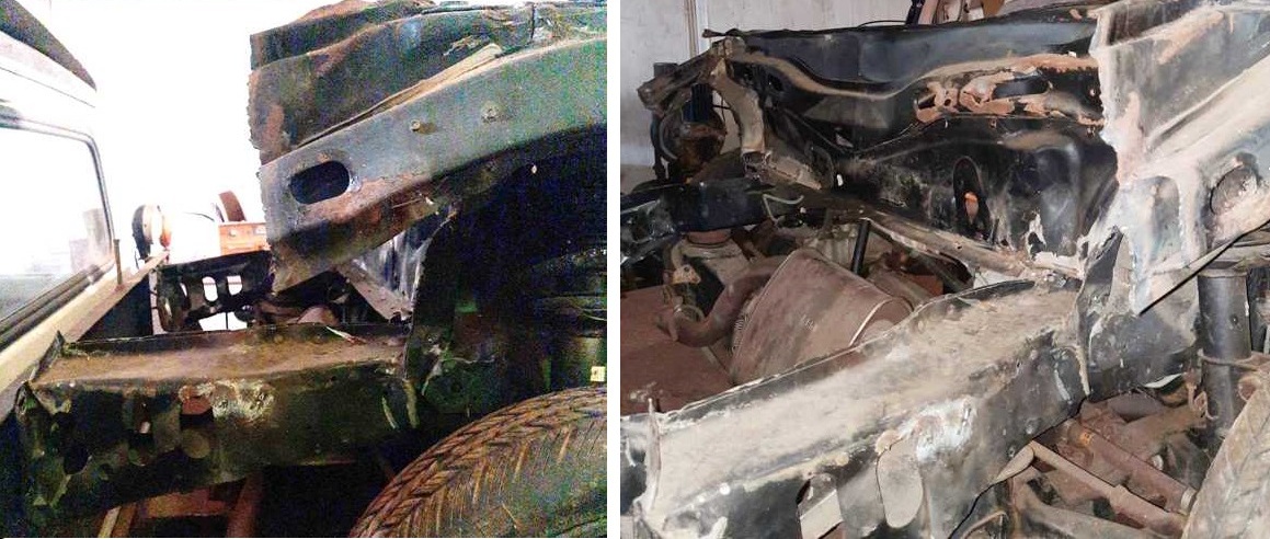

Vintage-Nut
NOV 26, 04:27 PM
The Photos Shows Major Welding....
The lower rails might be okay, but the upper rails were hacked off.
 [This message has been edited by Vintage-Nut (edited 11-26-2025).]
87FieroEnthusiast
NOV 26, 04:36 PM
| quote | Originally posted by Vintage-Nut:
I actually noticed that as well. The bottom rail on the passenger side seems to be ok, but the driver side rail may need cut off and a new one welded on. It looked pretty crunched to me.

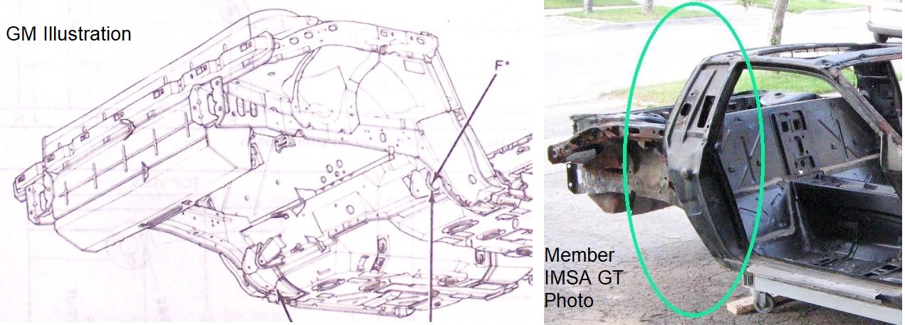

With it being hit hard in the rear, I would take a good look at where the upper frame rails attached to the center tub for the passenger compartment. It isn't uncommon for that area to get pushed in. If that it is the case, then likely everything behind the doors is out of alignment and likely not worth trying to repair.

Vintage-Nut
NOV 27, 04:01 PM
| quote | | /take a good look at where the upper frame rails attached to the center tub for the passenger compartment. |
I noticed that the rear glass was gone...
 [This message has been edited by Vintage-Nut (edited 11-27-2025).]
87FieroEnthusiast
NOV 28, 07:22 PM
Thank you for the reference picture. Also yeah, the car is missing interior parts and the rear glass. If it turns out to be fixable, I am going to take parts from the other 2 cars to complete the GT.
87FieroEnthusiast
NOV 29, 05:42 PM
I took another look at the whole back end of the GT. Unfortunately, it would not be very practical to save it. The back end is much worse than I thought. The whole back is crunched and smashed into the passenger cabin, not to mention the rear glass would never fit again with how bent the frame is. I would need to cut the car in half and weld on the back half of another frame to fix it. I talked to a guy who works in the auto collision business. We both took a look at the red 85 SE to see if it could be repaired (front end damage from running into something). He told me that the red 85 SE would be much easier to repair than the GT, so I am going to swap everything from the GT to the other frame and rebuild the red 85 into a GT. [This message has been edited by 87FieroEnthusiast (edited 11-29-2025).]
