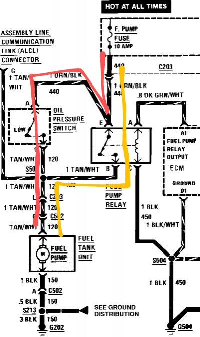

| quote | Originally posted by 1985 Fiero GT:
The fuel pump is run by both the ECM and the oil pressure sender, in parallel, as a "backup"system. The ECM should be what controls the fuel pump 100% of the time through its relay, the oil pressure switch only provides an additional path for more current to flow, or in the event of the ECM fuel relay failing, as a backup power source. A bad oil sender won't do anything unless the ECM relay is also damaged.
(I'm not 100% certain what's what on the 84s, I could be wrong, but I'm fairly certain) |
True but that backup system is a one way thing, if the fuel relay goes bad is will run off the oil pressure switch, but not the other way around. The design was that if you lose oil pressure (which could indicate big engine problems) the engine would automatically shut off to prevent damage. however if the switch was bad then it would shut off on you. that just made me think though, i haven't seen the oil light come on... is it run to a different sensor/switch?? this is all really confusing to me honestly because i am illiterate at diagnosing stuff (or in other words, i'm stupid). thanks again.

| quote | Originally posted by ironpuke84:
True but that backup system is a one way thing, if the fuel relay goes bad is will run off the oil pressure switch, but not the other way around. The design was that if you lose oil pressure (which could indicate big engine problems) the engine would automatically shut off to prevent damage. however if the switch was bad then it would shut off on you. that just made me think though, i haven't seen the oil light come on... is it run to a different sensor/switch?? this is all really confusing to me honestly because i am illiterate at diagnosing stuff (or in other words, i'm stupid). thanks again. |
It would be smart if it was designed that way, but it isn't, this is well documented on this forum and in the diagrams, at least for the v6, like I said maybe 84 was weird and different, but I don't think so in this case, the 2 switches are parallel, run from the same fuse, to the fuel pump, neither one is "connected" to the other except at the very beginning and very end, they're 2 parallel systems. The ECM should run the fuel pump for a few seconds when you first turn the key on but don't start it, that's with no oil pressure, but the pump is running, same when you first start cranking, it should fire right up, even though it would take a half second or more for oil pressure to build, then another half second or more for the fuel pump to build pressure, which would result in a long delay when starting (although that can also be caused by other things to)

- Oil Pressure / Fuel Pump Relay: As 1985 Fiero GT said... it's unfortunately not designed like you said, it's actually the exact opposite... a little. If the fuel relay fails... the oil pressure sending unit (which also has a switch in it) serves to engage the fuel pump IF the fuel pump relay has failed. That's because the assumption is... GM wanted you to still be able to drive the car if the fuel relay died while driving.
True but that backup system is a one way thing, if the fuel relay goes bad is will run off the oil pressure switch, but not the other way around. The design was that if you lose oil pressure (which could indicate big engine problems) the engine would automatically shut off to prevent damage. however if the switch was bad then it would shut off on you. |
You are incorrect.
