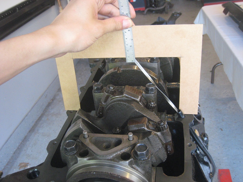

When I did the engine rebuild on my 3.1 (similar to 2.8 except for 8 mm longer stroke, so connecting rods come 4 mm closer to the oil surface) using a Fiero 2.8 dipstick, the stock Fiero oil levels seemed to make sense to me.
I made a cardboard mockup to simulate the bottom surface of the oil pan.
If the oil level is too high, then I think that this will create extra drag on the rotating assembly.
