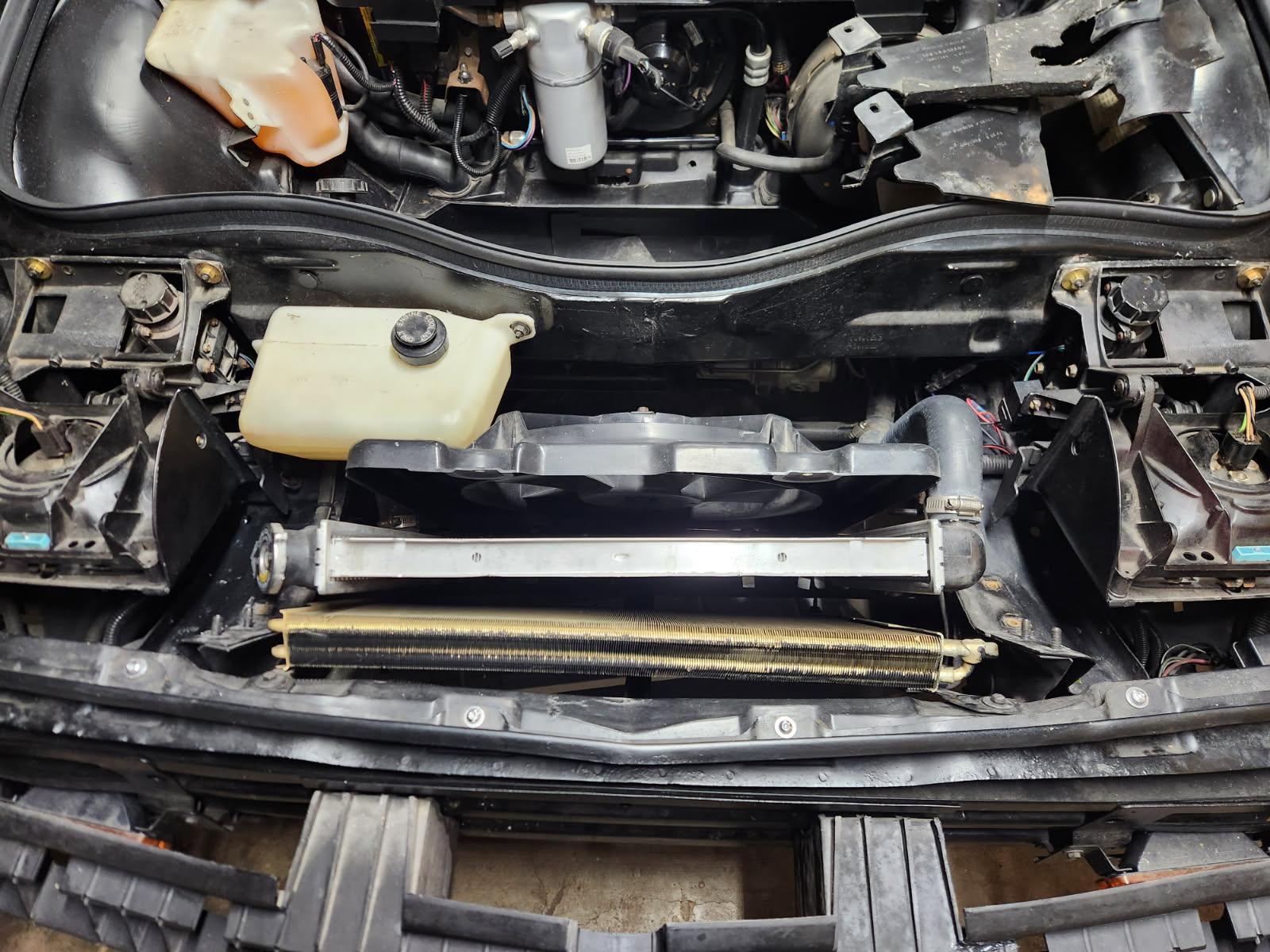

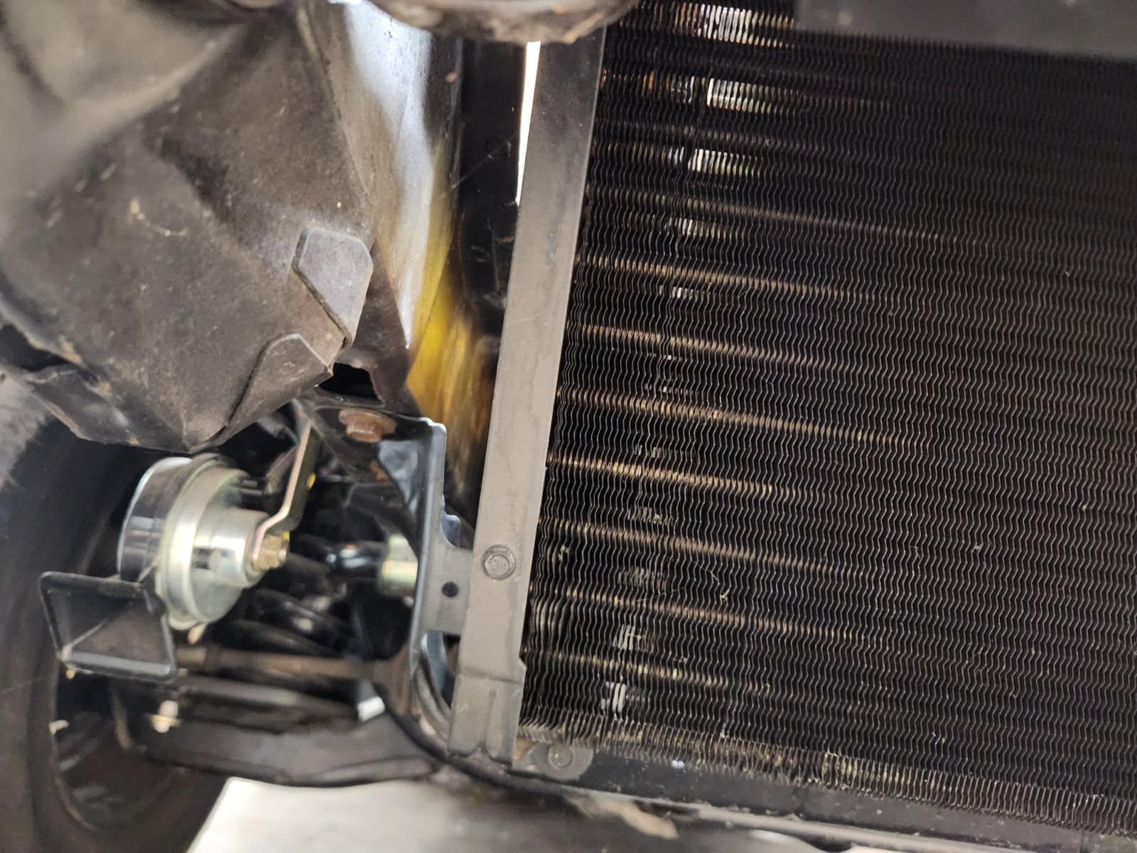

Figured I post a couple photos as I have the hood off at the moment.
Air baffles, plastic pieces, yeah. Do they work?
In short yes, it's about pressure drop and path of least resistance. Yes a condenser and radiator adds to the resistive force of air passing from one to another but without a way to direct it into the path your trying to cool? PITW I guess.

| quote | Originally posted by Stingray92:
Your fan shroud isn't normally set back from the radiator is it?
1985 Fiero GT
AUG 15, 11:58 PM
And I don't see the air dam on the front picture, with the fan shroud like that there's less room for air to make it's way down and out, not to mention air can just circulate around the fan without coming through the radiator, so that will decrease the airflow when stopped, and not having the air dam will decrease the airflow when moving.
correct, I'm looking for the passenger side plastic backing part of the baffle. I've got t the rubber seals from the Fiero Store.
Stingray92
AUG 16, 06:51 AM
| quote | Originally posted by 1985 Fiero GT:
And I don't see the air dam on the front picture, with the fan shroud like that there's less room for air to make it's way down and out, not to mention air can just circulate around the fan without coming through the radiator, so that will decrease the airflow when stopped, and not having the air dam will decrease the airflow when moving. |
The air dam is currently unbolted, still a fair amount to re-install...
1985 Fiero GT
AUG 16, 08:30 AM
The air dam is currently unbolted, still a fair amount to re-install... |
Ok, well with the shroud and air dam installed correctly, there shouldn't be any overheating. Gauges and sensors can lie, if you have one, you can use an infrared contactless thermometer on coolant hoses up front and in the engine bay to see if it confirms the temperatures your other gauge is showing. if it is really overheating, then it's either a bent or collapsed hose/pipe, or something gunking up the cooling system.
