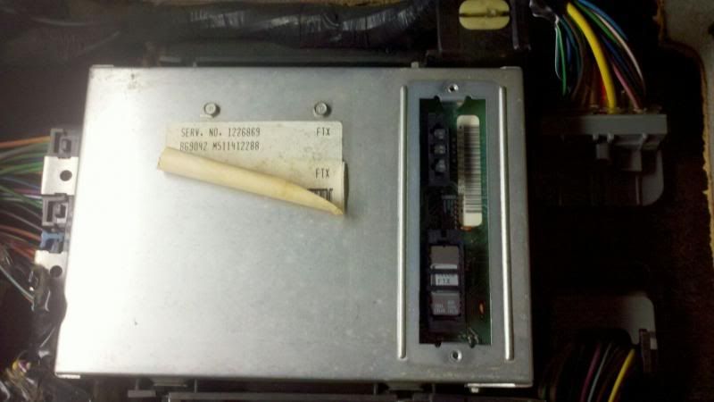

If you look at the ECM you have now, there's a little panel on the face of it. It's held on by two 7mm screws. You remove those two screws and the panel comes off the front, and you'll see the chip. Be very careful, but you pry the old chip out, and install the new chip. MAKE SURE you look at where the original chip was installed. You CAN accidentally install it backwards, and it will ruin the chip. There's a notch on the chip holder, and also a notch on the chip socket (on the motherboard). The notches need to line up.
Here's an image I found (not mine) that shows a Fiero ECM with the panel off... you can see where the chip is (the larger one at the bottom). Take note of the notch, and make sure you install the new chip in the same direction with the notch facing the center.
