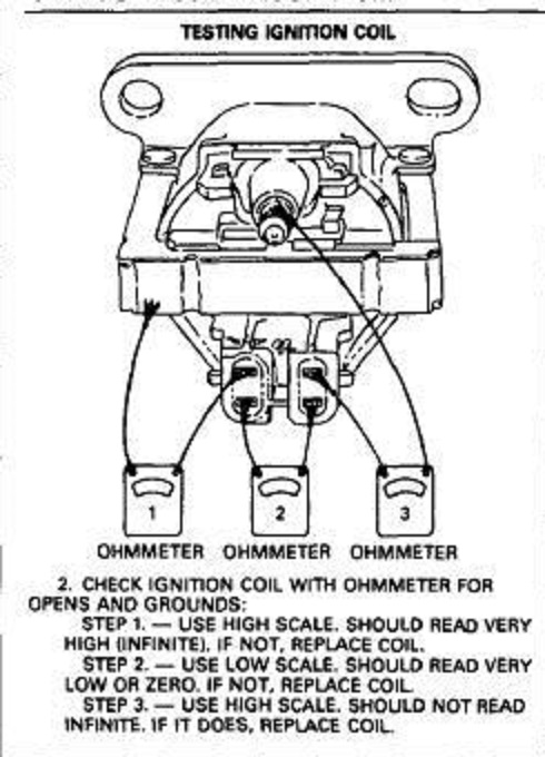

The ignition system on the Fiero V6 is the coil , the module and the pick up. When you engine is hot and refuses to start use an assistant to crank it over while you check the pulses going to the coil. If you do not have pulses then the module, or pickup is bad. If you can read pulses it is the coil. You can test the coil with an ohmmeter. If good and If you have a few bucks you can buy a new distributor with the module for about $70 from Rock Auto. It is a Chinese import but I am running an imported unit on my 4.9L and it works fine. That distributor also has the sensitive cam sensor in it. .

As Dennis said, "You can test the coil with an ohmmeter."

Step 1: Infinite Step 2: 0-.2Ohms Step 3: 7.42KOhms
This coil (GM GENUINE 19418995) was installed fall 2023 when the other one blew out after pairing it with low ohm Taylor cables. (not the popular swap ones that lots of people here recommend. After that I went back to the popular Taylor Spiro-Pro Spark Plug Wire 74224). Gonna hose down the connections, but there is no corrosion.
