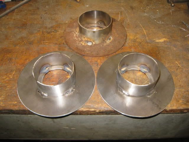

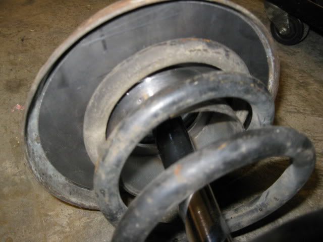

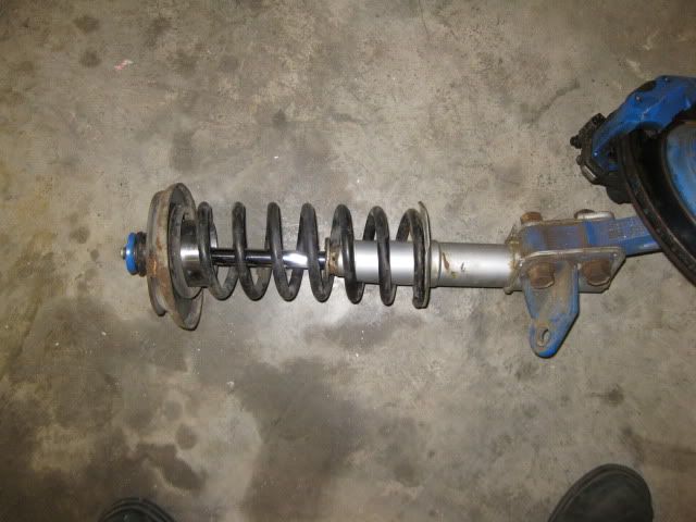

For the rear, again start with smaller cuts and work up to the amount of lowering. The cuts have to be from the top larger diameter of the spring as the lower portion has to rest in the lower spring perch.
As an alternative, cut down front springs can work in the rear if you make a flat plate with a centering ring for the top of the spring. This will give you a stiffer spring rate (220ish vs 145).
