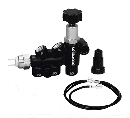

Can we focus on this before discussing the proportioning valve which is no longer OEM but is a Wilwood with the Knob to adjust the amount going to the rear.

The Willwood valve is the only thing not stock and is related to front-rear "issues". Did it come with detailed installation instructions?

btw some of this functionality is attributed to the proportioning valve and I had read that the fiero is really a combination valve and that the fail safe functionality is what is depicted in the video and is a function of the master cylinder and the proportioning valve just senses the imbalance of pressure and triggers the light on the dash

When I call wildwood on monday I will be asking them if the unit they recommend will not only have the same or close to same bore size and the twin resovoirs and take that into consideration before deciding what master cylinder to go with

yes it is. the proportioning valve isolates the flow between the front and rear and changes the pressure and fluid flow to an extent. can definitely recommend willwood for good masters though
