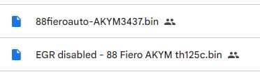

You don't need TunerPro to put things back to "stock" - EPROM dumps are easily enough to find on the internet for you car. All you need is someone with a burner to burn you a new chip and you just swap them out. You could try erasing what is in the car now, but with the age of some of these IC there is the possibility that the IC will fail when being erased and cannot be reprogrammed. I have come across this many times in my other hobby (vintage arcade games).
I have all the Fiero bin files here, just just need to match with the one that should go in your car (there is a label on the ECM - but really year, engine and transmission is all you need for the correct file (well and if you need the California tune). [URL=https://drive.google.com/drive/folders/19Hf3IvT9PYqQqiIs5osKTJ4Piy6oP4kW?fbclid=IwY2xjawE9nIVleHRuA2FlbQIxMAABHTS-jSuhwZpyU_SDkxRXdp9oq1VGmg3TYdoouRWlUHHAmFRXCEJFBI4mYA_aem_W8NOD7RNaLZe3tk4k9NlKQ]https://drive.google.com/dr...NOD7RNaLZe3tk4k9NlKQ[/URL ]
Edit - sorry, reread your original post. Sounds like you want an EGR delete chip for your year of car? If you are not getting a code 32, then the EPROM probably already has the changes made. Although there are differences between the automatic code and the manual.
I do have it documented someplace one the changes needed to delete the EGR properly, I will have to look for that. But if you download TunerCat, you can compare the 2 files in the parent directory from the above link to figure out what the differences are. These are the changes I made to my car a few years back - top one is original (as dumped). Technically since your car is the same as mine, you can just download the "deleted" code and have that burned to a EPROM and use on your car - the only thing I don't remember if that code includes some changes made as I am running a 3.4l. I don't think it does as I named contains wide BLM in the title.

This makes total sense, I saw most of these parameters however I did not see BPW Vs. EGR. Did you mean BPC Vs. EGR Duty Cycle? I understand that this is optional but I was curious. Also, your EGR Disabled - 88 Fiero AKYM th125c.bin file is not showing up in the link that was sent. Thank you so much for this detailed response btw!
Yes I am sure that is the case - been quite sometime since I was in there looking around - re: BPC Vs. EGR Duty Cycle
my file is not in the link I sent, those are OEM images - it is in the parent directory (which I thought I mentioned.
Anyways, here is the link to the parent directory: ht tps://drive.google.com/dr...NOD7RNaLZe3tk4k9NlKQ[This message has been edited by Mickey_Moose (edited 08-30-2024).]
