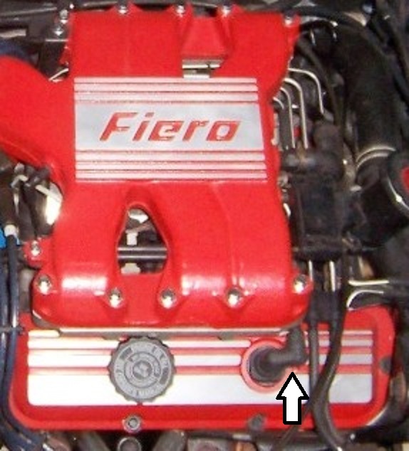

novafish:
i dont have the original {PCV} fitting / i can't seem to find that fitting anywhere online though.
The original rubber elbow on the V6 rear valve cover was removed by the GM Campaign 88-C-24 {a.k.a. '90 Recall}
This is a photo of the GM Recall PCV Rubber Fitting
And yes, finding a replacement will be difficult....
Patrick JUL 11, 12:18 AM
Ummm... I think there may be some misunderstanding here. The recall involved the front valve cover, not the valve cover by the trunk.
That PCV elbow you've indicated with an arrow on the rear valve cover has never been changed in any recall.
Here's an image of a pre-recall V6 (easily identified by the bizarre looking original rubber intake snorkel). That PCV elbow on the rear valve cover remains the same on all the V6's that have had the recall done.

Vintage-Nut JUL 11, 01:25 PM
Patrick:
You're correct - I admit my mistake and apologize!
I tried to find the part in the P-Book and finally found it.
This rubber 'double elbow' fitting on the V6 PCV was included in the vacuum line assembly and not sold as a separate part.
{Harness, exhaust gas recirculation valve vacuum, GM 10040419}
One solution to replace the original missing part is:
With a new PCV in hand {ACDelco CV892C}
Visit local auto stores to get an elbow which will fit on the valve AND will fit on an OD .375 tube {PCV vacuum line}
Then get an elbow which will fit on the PCV vacuum line {OD .375-inch}
If you 'saved' the old plastic tube when you installed the stainless-steel vacuum lines; use a short piece to connect the two elbow or perhaps cut the elbows to make the assembly shorter....
Good Luck!

Patrick JUL 11, 02:57 PM
Was there any logic to that design? Not to go off topic, I'm just curious why they designed it like that. Did it have something to do with attempting to prevent water from pouring in there or something?
IMO, there was no logic whatsoever. It was just weird! The factory air/water separator is/was always located just inside the rear fender.
No need for an apology! I just didn't want any confusion regarding the recall to arise from this.
