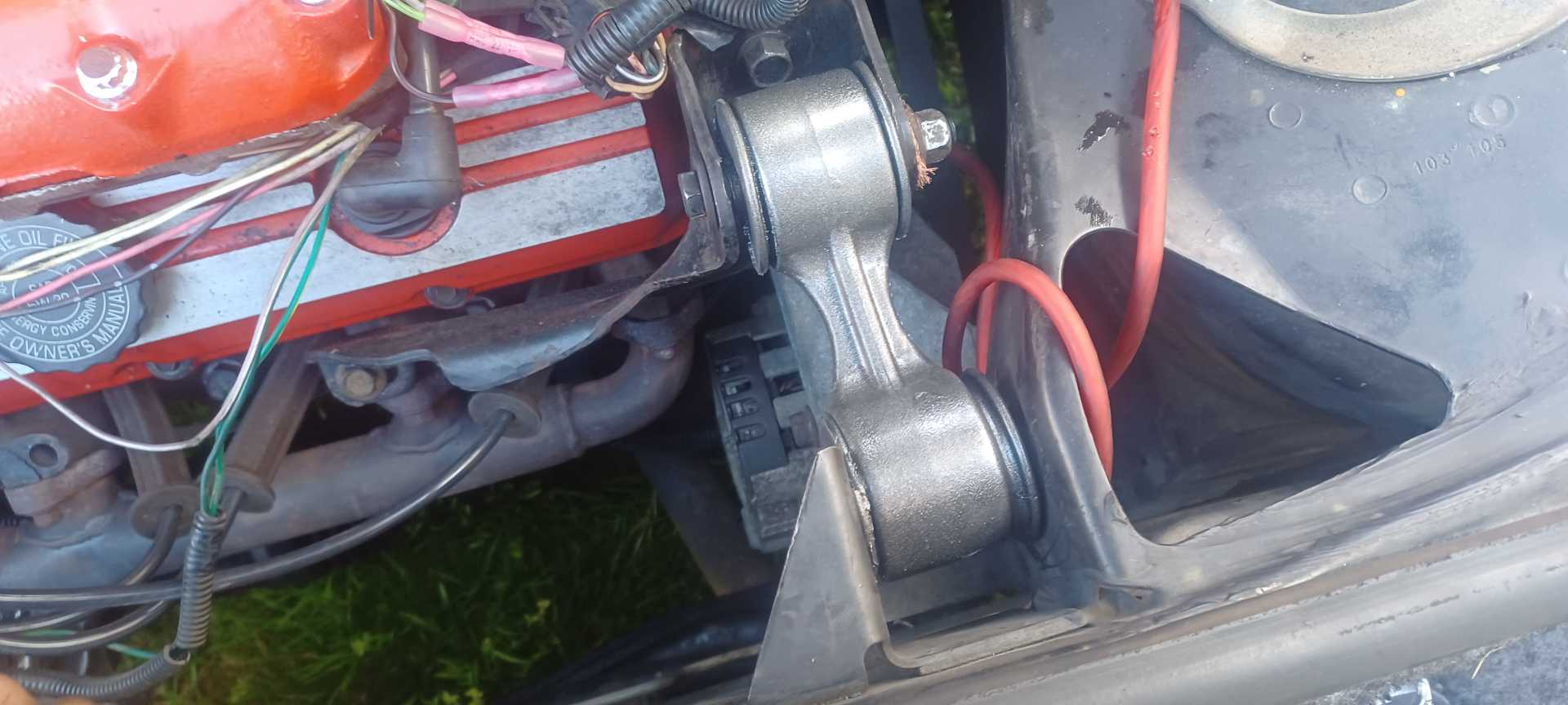

 The rear cradle on an 88 is solid mounted, if it's shifting it sounds like the rear vertical bolts are loose and the front horizontal bolts may be undersized.....
 see now that's much more helpful then "get it off the road"
 I will be checking the bolts for everything on the cradle and the cradle itself today to find what's loose and causing the violent smashing whether I'm on or off the throttle, based on previous experience with bolts and thus car I'm gonna assume they are mostly wrong or missing from rattling out due to the trumpet exhaust modification.
