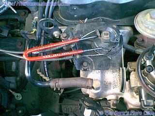

Example: 87 Engine uses 700 Series TBI w/ Different Head & Intake that need gas pedal, TV & Cruise cables made to fit this. Pic from Throttle cable cave page,
 Top cable goes around pulley then connect to bell crank on 700 TBI That cable has 2 "end" to engage the Pulley & TBI + has another end that hold jacket on the pulley bracket. Need 2 "ends" because TV cable pulled by the Pulley. If has Cruise, That uses the pulley too but has second pulley that pulls main pulley. Worse, Throttle & Cruise Cable sets are made as 1 piece for 87. So when car don't have Cruise from Factory, Is Way Harder to add any Cruise later. In some later years the cables are made as separate parts & bracket slot is mod'ed to take them.
Even if you have 87 Fiero & Throttle cable breaks... much harder to fix because how it's made. Why I saved a cable set when someone else junked 87 w/ l4.
