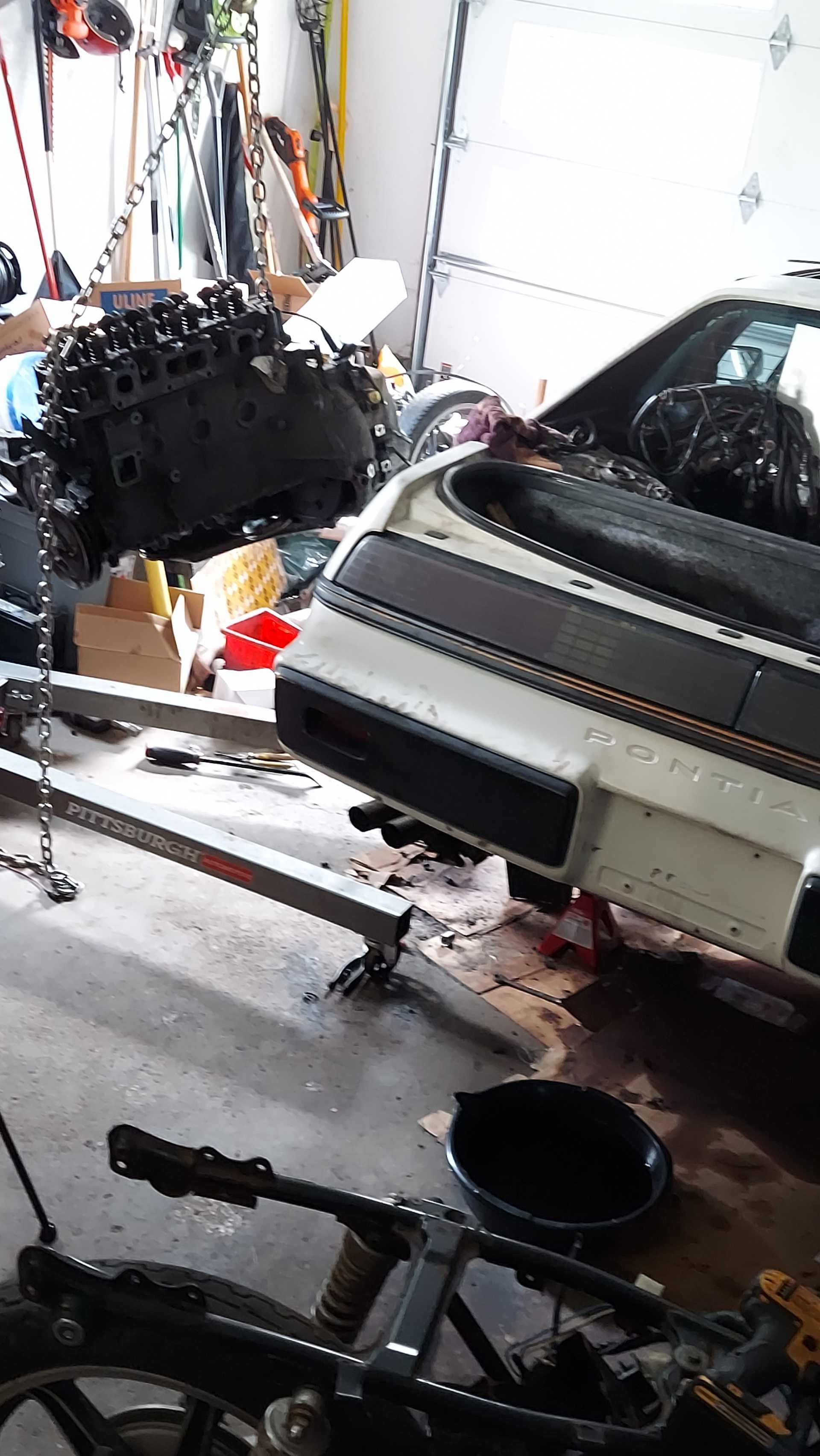

I DID IT.
THANK YALL FOR THE HELPFUL INFO
Ignore the garbage in the back I'm gonna call a junk yard to come pick the engine and the rest of the **** up to clear the garage up

Awesome!!!
But do NOT have the engine hauled off yet! Keep the engine until you have the new one installed and in the car. Trust me... you do not want to throw that engine away. You have no idea what parts you may still need from that motor. There's little things still bolted on it that you'll probably still want. Put the car back together first, and then get rid of all that stuff. You maybe also want to donate the engine to someone on here rather than pay someone to haul it.
What year did you say you had again? If you've got an 84 or an early 85, get a late 85 or 86 model engine so that you can use the newer block that has the roller cam and the newer harmonic balancer. Everything else bolts up to it.
