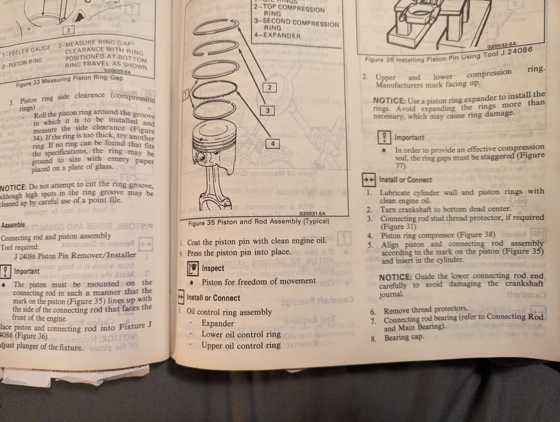

From the Factory Service Manual...

Hey Joe, but this is different. When I disassembled my V6/60, the pistons also had that little notch on the side, which is directional and referenced in the service manual.
BUT... we're talking about that hole that's drilled off-center in the middle, not the little notch on the edge/side of the piston. My V6/60 pistons did not have that hole drilled (I have one assembled on my bookshelf as a book-end if someone wants me to take a picture of it).

Just posting info from the FSM, as you said, the holes are neither mentioned nor illustrated.
