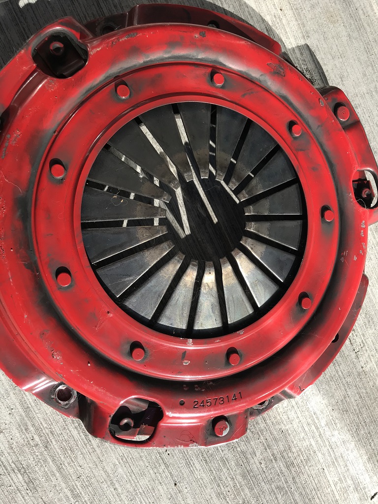

Got it out today and it was def. The pressure plate contacting the flywheel see attached. Spins over nice and easy now. My question is does anyone know the correct McLeod clutch for an izuzu 5 speed? Or is the 4 speed Muncie bellhousing interchangeable and have the proper clearance ??
jmac87tt
JUL 22, 06:49 PM
Sorry pics attached
Jay-ID
JUL 24, 12:21 PM
I did not have grinding like that on my Isuzu plus McLeod. The clearancing I needed to do was around the circumference of the clutch cover. The bolt heads on my cover look different and did not contact the transmission. I still have that clutch in my shop (I blew up 2nd gear on my Isuzu years ago). My McLeod clutch cover is 1-3/4" tall and has a diameter of 11-3/8". The number stamped on the cover is 24573141. You can see in image where I grinded some material from the edge. I also ground some from where those edges touched the transmission.
jmac87tt
JUL 24, 08:41 PM
Thanks for your help. My pressure plate also has an 11 3/8" diameter but has a 1 7/8" sprung height. No casting number. You can see in the picture where the contact points where
