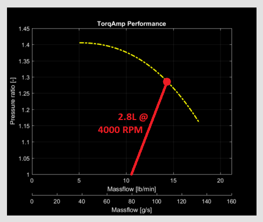

Plotting the "10.8 lb/min" point, and extrapolating (assuming that mass flow increases linearly with pressure ratio) until the compressor is maxed out, it looks like a pressure ratio of 1.28 is possible.
2.8 Fiero engine continues building power at higher RPM (like 5000+); in this range, I don't think the torqamp can increase peak power.
For 2500 Euro, I wouldn't get excited over this when much of the same effect (more low-end, midrange) could be had by bolting a 3.4L / 3.5L shortblock in place.
A normal turbo can cost a lot less than 2500 Euro and generate a pressure ratio of 2.0 or more...

173ci 6000RPM 70%VE = 200ish
173ci at 4000 RPM and 75% VE is 148 acfm which is 10.8 lbs/min at 100 kPa and 60 'F.
To accelerate quickly low end and mid-range torque are just as important as HP at 6000 rpm.

skywurz DEC 27, 09:23 PM
4psi > 1psi of static pressure this thing puts out
sanderson231 DEC 27, 09:26 PM
100 kPa = 14.5 psia. 1.28 * 14.5 psia = 18.6 psia - 14.5 psia = 4.1 psi of boost

skywurz DEC 27, 09:29 PM
Their own video says 1psi
