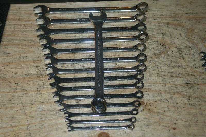

If you look at a flat wrench set, you'll notice that the smaller sizes are shorter in length than the larger sizes. The longer the handle, the greater the leverage, and the more you can tighten a nut/bolt. It's therefore pretty difficult for example to over-tighten a 7/16" nut with a six inch long wrench. And as long as you're using an appropriate length handle on a socket wrench, you'll usually be okay. In other words, don't start reefing on that same 7/16" nut using a 3/4" drive ratchet (or bar) with a two and a half foot long handle. For an oil drain plug, I'd either use the proper size box-end wrench, or the proper size socket with a 1/4" drive ratchet (or 3/8" drive if you're gentle).... and just snug it. It's not a head bolt!
