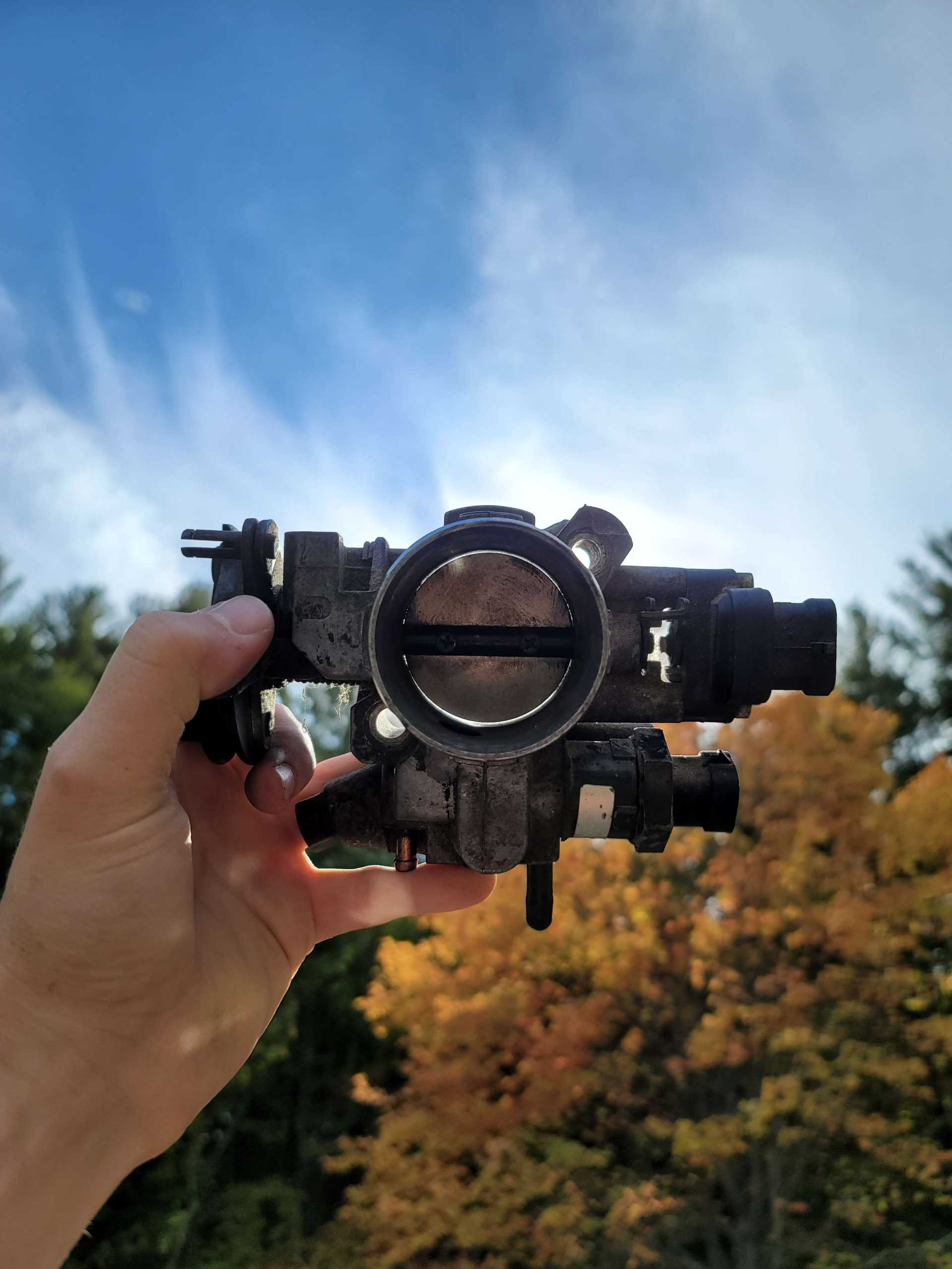

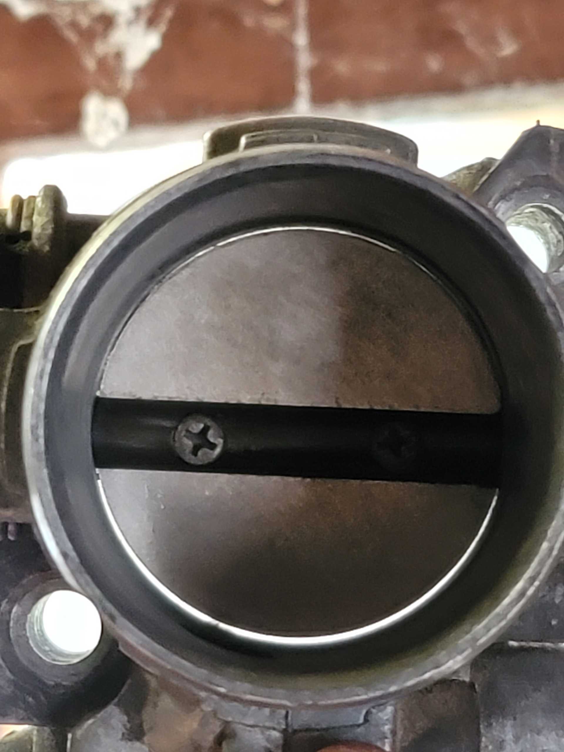

There doesnt seem to be any play or slop with the shaft/plate. there seems to be a lot of air gap around the throttle plate, however, im not sure how much there should be.

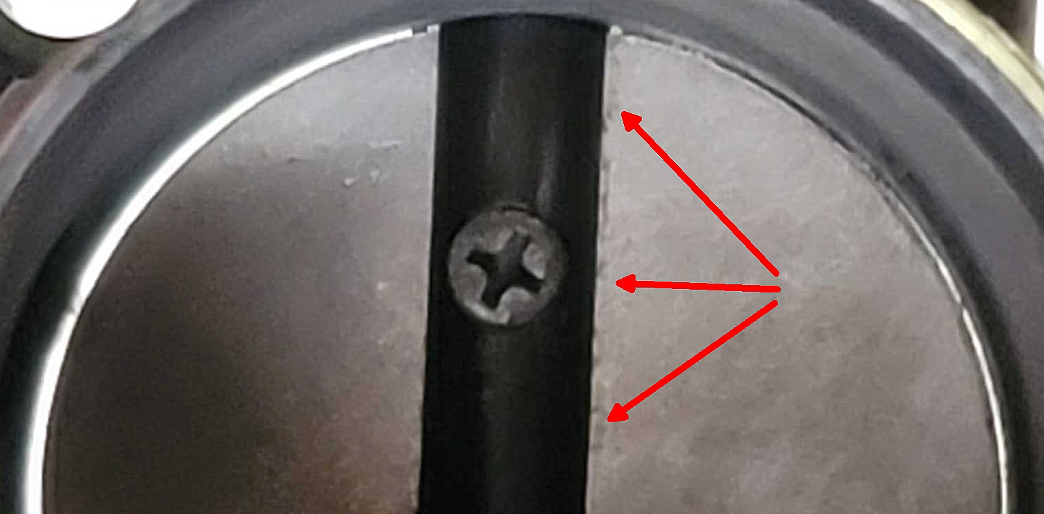

In my experience, the throttle plate should be only be held open enough at idle by the stop screw to prevent the plate/valve from binding in the TB bore.* I suspect that what I earlier suggested has indeed occurred! Never underestimate what a previous owner/mechanic may've done.
I suppose it is possible that someone could've reinstalled a plug after changing the idle stop setting, but that doesn't seem too likely.
* There is a "proper" procedure for returning the idle stop screw back to the factory setting. If you have trouble locating it, I can probably find it.
[EDIT] Is the end of the throttle stop screw actually what is preventing the throttle from closing any further? In other words... Is there any chance that the two screws holding the throttle plate in the shaft have been loosened/removed and the plate re-positioned somewhat, just enough to possibly prevent the plate/valve from closing all the way? Doubtful, but I'm trying to imagine any/all potential scenarios.
[EDIT 2] Looking at this closer, it actually does look like the throttle plate may have been shifted on the shaft.

I actually took the plate out after seeing the gap, and cleaned it and the TB bore up some. I fiddled around with different rotations for the plate install, but none of them kept it really seated. The screw is definitely what is stopping it. You cant see it in the image but there was air gap around 100% of the plate, although miniscule at the sides, it was still clearance, so the plate couldn't be stopping it.

Ah... okay, that explains what I saw in your photo! You may be able to better center the plate on the shaft when you temporarily back the idle stop screw right out so that the throttle closes all the way (...and then re-set the idle stop).[This message has been edited by Patrick (edited 10-06-2022).]

The gap was like that before i took the plate out. Here's a picture i took with the TB fresh off the car, before i did anything to it.

Oh, I don't doubt it... but I was more referring to the plate now being a bit offset in the shaft.
If you look closely at the enlarged photo that I posted above, you can clearly see that the plate has been re-positioned to the right. Not only is there evidence of the original shaft position marked on the plate (indicated by the arrows), but notice the difference in light getting past the plate on either side. Way more light to the left of the plate.[This message has been edited by Patrick (edited 10-06-2022).]
