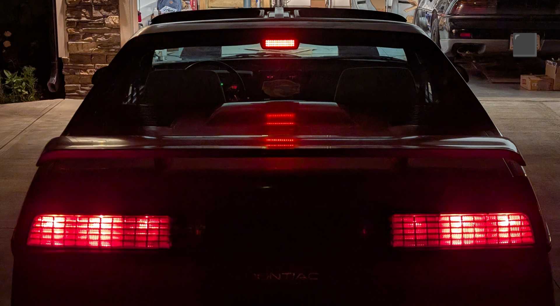

Good post. Worked great for me. I put in a flasher with a g-meter from Cravenspeed between the LED panel and the bulb connector, it'll only flash when you're going faster and braking quickly.

Looks good! I'm happy you found the information I posted useful.
