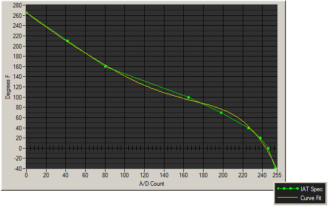

I have been calling it MAT and I agree MAT and IAT are the same sensor and engines have one or the other. And yes, I will start calling it an IAT because it is located on the air cleaner and not on the intake manifold (or the plenum - the upper part of the manifold on Fieros, right?). I guess the temperature may read higher if it was on the manifold. But I noticed that it is very thermally conductive - just holding the sensor body in my hand was enough to see it respond. So, yes, it should read a higher temp if the engine is off but the engine compartment is hot from the engine. That would heat the outer body of the sensor (and read a higher temp) until the engine is started and cooler air is drawn over the thermistor in the sensor.
So, I fixed the IAT wires that the mouse bit through - my repair is very weather proof... still waiting on the stainless steel braid to cover it. I tested it today and I now get a solid 143 at 74 F (or something around that - I didn't pay attention to value just yet, I just wanted to see how stable it was) over the ALDL.
I found specs on the new IAT that I have and confirmed it by dipping just the thermistor tip (yes, mine is well coated in epoxy and no exposed copper wires) in the freezer, ice water, room air, and boling hot water. I used a digital thermometer right next to the thermistor and let it stabilze 1 minute before taking a reading - this way I got 4 resistance readings from the sensor vs the temperature of the sensor at that moment. They matched pretty close to spec. I did a curve fit from the spec values and found a 5th order polynomial that fits well from -40F up to 155F, after that, the curve becomes more linear to 280F (the air should never be that hot, but until I see how the ECM responds to it (0 to 255) I will assume a wider range for now. So now I have to apply 8 various resistance values from the spec to the IAT connector and see what the ALDL shows for each. I have a precision potentiometer for that. Then I can do another curve fit to get the coefficients so my GUI can display the raw ALDL byte data in very accurate degrees F or C and not just raw ADC values.

I applied the IAT sensor resistor values from the spec to the pins on the IAT connector and correlated them to A/D counts out of the ECM on the ALDL stream.
I got a good curve fit from those readings. There are only 8 sample points in the spec, I wish they speced it at every 10 degrees. Anyway, I now have the coefficients to convert the raw ADC value to degrees F and C.
I think GM probably did a linear interpolation between the 8 points from the spec. My curve looks more like what I expect from thermistors and such. So internally the ECM is using a linear interpolation of temperature, but for the human I show a temperature that matches a bit closer to what the IAT is seeing. They are only off by a few degrees - close enough for the girls I go with. I am sure the manufacturer rounded out the resistance values in the spec, they are too "perfect" for what thermistors normally produce over temperature. I can attribute that to my Mean Squared Error being above 1.0.
code:
Fiero IAT Sensor to ALDL Raw Data to Degrees F Curve Fit Analysis Paul Romsky: 21 AUG 2022 02:50 UTC PolyFit Status = 0 PolyFit Description : The call was successful. Samples = 9 Order = 5 Sample[0] = 0 A/D Count 265.0 F 0 Ohms (not from IAT Spec but extrapolated after intial fitting) Sample[1] = 42 A/D Count 210.0 F 185 Ohms Sample[2] = 80 A/D Count 160.0 F 450 Ohms Sample[3] = 165 A/D Count 100.0 F 1800 Ohms Sample[4] = 198 A/D Count 70.0 F 3400 Ohms Sample[5] = 226 A/D Count 40.0 F 7500 Ohms Sample[6] = 238 A/D Count 20.0 F 13500 Ohms Sample[7] = 246 A/D Count 0.0 F 25000 Ohms Sample[8] = 253 A/D Count -40.0 F 100700 Ohms Polynomial Value[0] = 265.324535579 Polynomial Value[1] = 208.322676029 Polynomial Value[2] = 162.515911003 Polynomial Value[3] = 94.727826653 Polynomial Value[4] = 76.218405233 Polynomial Value[5] = 42.560100081 Polynomial Value[6] = 16.153891421 Polynomial Value[7] = -7.558715392 Polynomial Value[8] = -33.265884441 Coefficient[0] = 265.32453557883354733348824083805084 Coefficient[1] = -1.52270182439165147059156879549846 Coefficient[2] = 0.00652957182822441750680297900544 Coefficient[3] = -0.00008555290123399544172100306128 Coefficient[4] = 0.00000063156253227325711538430245 Coefficient[5] = -0.00000000147932562724227110795653 Mean_Squared_Error = 22.17134189086306150784366764128208 Equation: Degrees F = Coefficient[0] + (Coefficient[1] * A/D_Count) + (Coefficient[2] * pow(A/D_Count, 2)) + (Coefficient[3] * pow(A/D_Count, 3)) + (Coefficient[4] * pow(A/D_Count, 4)) + (Coefficient[5] * pow(A/D_Count, 5)) X = 0 A/D Count Y = 265.3 Degrees F (129.6 Degrees C) X = 1 A/D Count Y = 263.8 Degrees F (128.8 Degrees C) X = 2 A/D Count Y = 262.3 Degrees F (127.9 Degrees C) X = 3 A/D Count Y = 260.8 Degrees F (127.1 Degrees C) X = 4 A/D Count Y = 259.3 Degrees F (126.3 Degrees C) X = 5 A/D Count Y = 257.9 Degrees F (125.5 Degrees C) X = 6 A/D Count Y = 256.4 Degrees F (124.7 Degrees C) X = 7 A/D Count Y = 255.0 Degrees F (123.9 Degrees C) X = 8 A/D Count Y = 253.5 Degrees F (123.1 Degrees C) X = 9 A/D Count Y = 252.1 Degrees F (122.3 Degrees C) X = 10 A/D Count Y = 250.7 Degrees F (121.5 Degrees C) X = 11 A/D Count Y = 249.3 Degrees F (120.7 Degrees C) X = 12 A/D Count Y = 247.9 Degrees F (119.9 Degrees C) X = 13 A/D Count Y = 246.5 Degrees F (119.1 Degrees C) X = 14 A/D Count Y = 245.1 Degrees F (118.4 Degrees C) X = 15 A/D Count Y = 243.7 Degrees F (117.6 Degrees C) X = 16 A/D Count Y = 242.3 Degrees F (116.8 Degrees C) X = 17 A/D Count Y = 241.0 Degrees F (116.1 Degrees C) X = 18 A/D Count Y = 239.6 Degrees F (115.3 Degrees C) X = 19 A/D Count Y = 238.2 Degrees F (114.6 Degrees C) X = 20 A/D Count Y = 236.9 Degrees F (113.8 Degrees C) X = 21 A/D Count Y = 235.6 Degrees F (113.1 Degrees C) X = 22 A/D Count Y = 234.2 Degrees F (112.3 Degrees C) X = 23 A/D Count Y = 232.9 Degrees F (111.6 Degrees C) X = 24 A/D Count Y = 231.6 Degrees F (110.9 Degrees C) X = 25 A/D Count Y = 230.2 Degrees F (110.1 Degrees C) X = 26 A/D Count Y = 228.9 Degrees F (109.4 Degrees C) X = 27 A/D Count Y = 227.6 Degrees F (108.7 Degrees C) X = 28 A/D Count Y = 226.3 Degrees F (107.9 Degrees C) X = 29 A/D Count Y = 225.0 Degrees F (107.2 Degrees C) X = 30 A/D Count Y = 223.7 Degrees F (106.5 Degrees C) X = 31 A/D Count Y = 222.4 Degrees F (105.8 Degrees C) X = 32 A/D Count Y = 221.1 Degrees F (105.1 Degrees C) X = 33 A/D Count Y = 219.8 Degrees F (104.3 Degrees C) X = 34 A/D Count Y = 218.5 Degrees F (103.6 Degrees C) X = 35 A/D Count Y = 217.2 Degrees F (102.9 Degrees C) X = 36 A/D Count Y = 215.9 Degrees F (102.2 Degrees C) X = 37 A/D Count Y = 214.7 Degrees F (101.5 Degrees C) X = 38 A/D Count Y = 213.4 Degrees F (100.8 Degrees C) X = 39 A/D Count Y = 212.1 Degrees F (100.1 Degrees C) X = 40 A/D Count Y = 210.9 Degrees F ( 99.4 Degrees C) X = 41 A/D Count Y = 209.6 Degrees F ( 98.7 Degrees C) X = 42 A/D Count Y = 208.3 Degrees F ( 98.0 Degrees C) X = 43 A/D Count Y = 207.1 Degrees F ( 97.3 Degrees C) X = 44 A/D Count Y = 205.8 Degrees F ( 96.6 Degrees C) X = 45 A/D Count Y = 204.5 Degrees F ( 95.9 Degrees C) X = 46 A/D Count Y = 203.3 Degrees F ( 95.2 Degrees C) X = 47 A/D Count Y = 202.0 Degrees F ( 94.5 Degrees C) X = 48 A/D Count Y = 200.8 Degrees F ( 93.8 Degrees C) X = 49 A/D Count Y = 199.5 Degrees F ( 93.1 Degrees C) X = 50 A/D Count Y = 198.3 Degrees F ( 92.4 Degrees C) X = 51 A/D Count Y = 197.1 Degrees F ( 91.7 Degrees C) X = 52 A/D Count Y = 195.8 Degrees F ( 91.0 Degrees C) X = 53 A/D Count Y = 194.6 Degrees F ( 90.3 Degrees C) X = 54 A/D Count Y = 193.4 Degrees F ( 89.6 Degrees C) X = 55 A/D Count Y = 192.1 Degrees F ( 89.0 Degrees C) X = 56 A/D Count Y = 190.9 Degrees F ( 88.3 Degrees C) X = 57 A/D Count Y = 189.7 Degrees F ( 87.6 Degrees C) X = 58 A/D Count Y = 188.5 Degrees F ( 86.9 Degrees C) X = 59 A/D Count Y = 187.2 Degrees F ( 86.2 Degrees C) X = 60 A/D Count Y = 186.0 Degrees F ( 85.6 Degrees C) X = 61 A/D Count Y = 184.8 Degrees F ( 84.9 Degrees C) X = 62 A/D Count Y = 183.6 Degrees F ( 84.2 Degrees C) X = 63 A/D Count Y = 182.4 Degrees F ( 83.6 Degrees C) X = 64 A/D Count Y = 181.2 Degrees F ( 82.9 Degrees C) X = 65 A/D Count Y = 180.0 Degrees F ( 82.2 Degrees C) X = 66 A/D Count Y = 178.8 Degrees F ( 81.6 Degrees C) X = 67 A/D Count Y = 177.6 Degrees F ( 80.9 Degrees C) X = 68 A/D Count Y = 176.4 Degrees F ( 80.2 Degrees C) X = 69 A/D Count Y = 175.2 Degrees F ( 79.6 Degrees C) X = 70 A/D Count Y = 174.1 Degrees F ( 78.9 Degrees C) X = 71 A/D Count Y = 172.9 Degrees F ( 78.3 Degrees C) X = 72 A/D Count Y = 171.7 Degrees F ( 77.6 Degrees C) X = 73 A/D Count Y = 170.6 Degrees F ( 77.0 Degrees C) X = 74 A/D Count Y = 169.4 Degrees F ( 76.3 Degrees C) X = 75 A/D Count Y = 168.2 Degrees F ( 75.7 Degrees C) X = 76 A/D Count Y = 167.1 Degrees F ( 75.0 Degrees C) X = 77 A/D Count Y = 165.9 Degrees F ( 74.4 Degrees C) X = 78 A/D Count Y = 164.8 Degrees F ( 73.8 Degrees C) X = 79 A/D Count Y = 163.6 Degrees F ( 73.1 Degrees C) X = 80 A/D Count Y = 162.5 Degrees F ( 72.5 Degrees C) X = 81 A/D Count Y = 161.4 Degrees F ( 71.9 Degrees C) X = 82 A/D Count Y = 160.3 Degrees F ( 71.3 Degrees C) X = 83 A/D Count Y = 159.2 Degrees F ( 70.6 Degrees C) X = 84 A/D Count Y = 158.0 Degrees F ( 70.0 Degrees C) X = 85 A/D Count Y = 156.9 Degrees F ( 69.4 Degrees C) X = 86 A/D Count Y = 155.8 Degrees F ( 68.8 Degrees C) X = 87 A/D Count Y = 154.7 Degrees F ( 68.2 Degrees C) X = 88 A/D Count Y = 153.7 Degrees F ( 67.6 Degrees C) X = 89 A/D Count Y = 152.6 Degrees F ( 67.0 Degrees C) X = 90 A/D Count Y = 151.5 Degrees F ( 66.4 Degrees C) X = 91 A/D Count Y = 150.4 Degrees F ( 65.8 Degrees C) X = 92 A/D Count Y = 149.4 Degrees F ( 65.2 Degrees C) X = 93 A/D Count Y = 148.3 Degrees F ( 64.6 Degrees C) X = 94 A/D Count Y = 147.3 Degrees F ( 64.0 Degrees C) X = 95 A/D Count Y = 146.2 Degrees F ( 63.5 Degrees C) X = 96 A/D Count Y = 145.2 Degrees F ( 62.9 Degrees C) X = 97 A/D Count Y = 144.2 Degrees F ( 62.3 Degrees C) X = 98 A/D Count Y = 143.2 Degrees F ( 61.8 Degrees C) X = 99 A/D Count Y = 142.2 Degrees F ( 61.2 Degrees C) X = 100 A/D Count Y = 141.2 Degrees F ( 60.6 Degrees C) X = 101 A/D Count Y = 140.2 Degrees F ( 60.1 Degrees C) X = 102 A/D Count Y = 139.2 Degrees F ( 59.5 Degrees C) X = 103 A/D Count Y = 138.2 Degrees F ( 59.0 Degrees C) X = 104 A/D Count Y = 137.2 Degrees F ( 58.5 Degrees C) X = 105 A/D Count Y = 136.3 Degrees F ( 57.9 Degrees C) X = 106 A/D Count Y = 135.3 Degrees F ( 57.4 Degrees C) X = 107 A/D Count Y = 134.4 Degrees F ( 56.9 Degrees C) X = 108 A/D Count Y = 133.4 Degrees F ( 56.4 Degrees C) X = 109 A/D Count Y = 132.5 Degrees F ( 55.8 Degrees C) X = 110 A/D Count Y = 131.6 Degrees F ( 55.3 Degrees C) X = 111 A/D Count Y = 130.7 Degrees F ( 54.8 Degrees C) X = 112 A/D Count Y = 129.8 Degrees F ( 54.3 Degrees C) X = 113 A/D Count Y = 128.9 Degrees F ( 53.8 Degrees C) X = 114 A/D Count Y = 128.0 Degrees F ( 53.3 Degrees C) X = 115 A/D Count Y = 127.2 Degrees F ( 52.9 Degrees C) X = 116 A/D Count Y = 126.3 Degrees F ( 52.4 Degrees C) X = 117 A/D Count Y = 125.4 Degrees F ( 51.9 Degrees C) X = 118 A/D Count Y = 124.6 Degrees F ( 51.4 Degrees C) X = 119 A/D Count Y = 123.8 Degrees F ( 51.0 Degrees C) X = 120 A/D Count Y = 122.9 Degrees F ( 50.5 Degrees C) X = 121 A/D Count Y = 122.1 Degrees F ( 50.1 Degrees C) X = 122 A/D Count Y = 121.3 Degrees F ( 49.6 Degrees C) X = 123 A/D Count Y = 120.5 Degrees F ( 49.2 Degrees C) X = 124 A/D Count Y = 119.7 Degrees F ( 48.7 Degrees C) X = 125 A/D Count Y = 119.0 Degrees F ( 48.3 Degrees C) X = 126 A/D Count Y = 118.2 Degrees F ( 47.9 Degrees C) X = 127 A/D Count Y = 117.4 Degrees F ( 47.5 Degrees C) X = 128 A/D Count Y = 116.7 Degrees F ( 47.0 Degrees C) X = 129 A/D Count Y = 115.9 Degrees F ( 46.6 Degrees C) X = 130 A/D Count Y = 115.2 Degrees F ( 46.2 Degrees C) X = 131 A/D Count Y = 114.5 Degrees F ( 45.8 Degrees C) X = 132 A/D Count Y = 113.8 Degrees F ( 45.4 Degrees C) X = 133 A/D Count Y = 113.1 Degrees F ( 45.0 Degrees C) X = 134 A/D Count Y = 112.4 Degrees F ( 44.7 Degrees C) X = 135 A/D Count Y = 111.7 Degrees F ( 44.3 Degrees C) X = 136 A/D Count Y = 111.0 Degrees F ( 43.9 Degrees C) X = 137 A/D Count Y = 110.4 Degrees F ( 43.5 Degrees C) X = 138 A/D Count Y = 109.7 Degrees F ( 43.2 Degrees C) X = 139 A/D Count Y = 109.1 Degrees F ( 42.8 Degrees C) X = 140 A/D Count Y = 108.4 Degrees F ( 42.5 Degrees C) X = 141 A/D Count Y = 107.8 Degrees F ( 42.1 Degrees C) X = 142 A/D Count Y = 107.2 Degrees F ( 41.8 Degrees C) X = 143 A/D Count Y = 106.6 Degrees F ( 41.4 Degrees C) X = 144 A/D Count Y = 106.0 Degrees F ( 41.1 Degrees C) X = 145 A/D Count Y = 105.4 Degrees F ( 40.8 Degrees C) X = 146 A/D Count Y = 104.8 Degrees F ( 40.4 Degrees C) X = 147 A/D Count Y = 104.2 Degrees F ( 40.1 Degrees C) X = 148 A/D Count Y = 103.6 Degrees F ( 39.8 Degrees C) X = 149 A/D Count Y = 103.0 Degrees F ( 39.5 Degrees C) X = 150 A/D Count Y = 102.5 Degrees F ( 39.2 Degrees C) X = 151 A/D Count Y = 101.9 Degrees F ( 38.9 Degrees C) X = 152 A/D Count Y = 101.4 Degrees F ( 38.5 Degrees C) X = 153 A/D Count Y = 100.8 Degrees F ( 38.2 Degrees C) X = 154 A/D Count Y = 100.3 Degrees F ( 37.9 Degrees C) X = 155 A/D Count Y = 99.8 Degrees F ( 37.7 Degrees C) X = 156 A/D Count Y = 99.3 Degrees F ( 37.4 Degrees C) X = 157 A/D Count Y = 98.7 Degrees F ( 37.1 Degrees C) X = 158 A/D Count Y = 98.2 Degrees F ( 36.8 Degrees C) X = 159 A/D Count Y = 97.7 Degrees F ( 36.5 Degrees C) X = 160 A/D Count Y = 97.2 Degrees F ( 36.2 Degrees C) X = 161 A/D Count Y = 96.7 Degrees F ( 35.9 Degrees C) X = 162 A/D Count Y = 96.2 Degrees F ( 35.7 Degrees C) X = 163 A/D Count Y = 95.7 Degrees F ( 35.4 Degrees C) X = 164 A/D Count Y = 95.2 Degrees F ( 35.1 Degrees C) X = 165 A/D Count Y = 94.7 Degrees F ( 34.8 Degrees C) X = 166 A/D Count Y = 94.2 Degrees F ( 34.6 Degrees C) X = 167 A/D Count Y = 93.8 Degrees F ( 34.3 Degrees C) X = 168 A/D Count Y = 93.3 Degrees F ( 34.0 Degrees C) X = 169 A/D Count Y = 92.8 Degrees F ( 33.8 Degrees C) X = 170 A/D Count Y = 92.3 Degrees F ( 33.5 Degrees C) X = 171 A/D Count Y = 91.8 Degrees F ( 33.2 Degrees C) X = 172 A/D Count Y = 91.3 Degrees F ( 33.0 Degrees C) X = 173 A/D Count Y = 90.8 Degrees F ( 32.7 Degrees C) X = 174 A/D Count Y = 90.3 Degrees F ( 32.4 Degrees C) X = 175 A/D Count Y = 89.8 Degrees F ( 32.1 Degrees C) X = 176 A/D Count Y = 89.3 Degrees F ( 31.9 Degrees C) X = 177 A/D Count Y = 88.8 Degrees F ( 31.6 Degrees C) X = 178 A/D Count Y = 88.3 Degrees F ( 31.3 Degrees C) X = 179 A/D Count Y = 87.8 Degrees F ( 31.0 Degrees C) X = 180 A/D Count Y = 87.3 Degrees F ( 30.7 Degrees C) X = 181 A/D Count Y = 86.8 Degrees F ( 30.4 Degrees C) X = 182 A/D Count Y = 86.3 Degrees F ( 30.1 Degrees C) X = 183 A/D Count Y = 85.7 Degrees F ( 29.8 Degrees C) X = 184 A/D Count Y = 85.2 Degrees F ( 29.5 Degrees C) X = 185 A/D Count Y = 84.6 Degrees F ( 29.2 Degrees C) X = 186 A/D Count Y = 84.1 Degrees F ( 28.9 Degrees C) X = 187 A/D Count Y = 83.5 Degrees F ( 28.6 Degrees C) X = 188 A/D Count Y = 82.9 Degrees F ( 28.3 Degrees C) X = 189 A/D Count Y = 82.3 Degrees F ( 27.9 Degrees C) X = 190 A/D Count Y = 81.7 Degrees F ( 27.6 Degrees C) X = 191 A/D Count Y = 81.1 Degrees F ( 27.3 Degrees C) X = 192 A/D Count Y = 80.4 Degrees F ( 26.9 Degrees C) X = 193 A/D Count Y = 79.8 Degrees F ( 26.5 Degrees C) X = 194 A/D Count Y = 79.1 Degrees F ( 26.2 Degrees C) X = 195 A/D Count Y = 78.4 Degrees F ( 25.8 Degrees C) X = 196 A/D Count Y = 77.7 Degrees F ( 25.4 Degrees C) X = 197 A/D Count Y = 77.0 Degrees F ( 25.0 Degrees C) X = 198 A/D Count Y = 76.2 Degrees F ( 24.6 Degrees C) X = 199 A/D Count Y = 75.5 Degrees F ( 24.1 Degrees C) X = 200 A/D Count Y = 74.7 Degrees F ( 23.7 Degrees C) X = 201 A/D Count Y = 73.8 Degrees F ( 23.2 Degrees C) X = 202 A/D Count Y = 73.0 Degrees F ( 22.8 Degrees C) X = 203 A/D Count Y = 72.1 Degrees F ( 22.3 Degrees C) X = 204 A/D Count Y = 71.3 Degrees F ( 21.8 Degrees C) X = 205 A/D Count Y = 70.3 Degrees F ( 21.3 Degrees C) X = 206 A/D Count Y = 69.4 Degrees F ( 20.8 Degrees C) X = 207 A/D Count Y = 68.4 Degrees F ( 20.2 Degrees C) X = 208 A/D Count Y = 67.4 Degrees F ( 19.7 Degrees C) X = 209 A/D Count Y = 66.4 Degrees F ( 19.1 Degrees C) X = 210 A/D Count Y = 65.3 Degrees F ( 18.5 Degrees C) X = 211 A/D Count Y = 64.2 Degrees F ( 17.9 Degrees C) X = 212 A/D Count Y = 63.1 Degrees F ( 17.3 Degrees C) X = 213 A/D Count Y = 61.9 Degrees F ( 16.6 Degrees C) X = 214 A/D Count Y = 60.7 Degrees F ( 15.9 Degrees C) X = 215 A/D Count Y = 59.4 Degrees F ( 15.2 Degrees C) X = 216 A/D Count Y = 58.1 Degrees F ( 14.5 Degrees C) X = 217 A/D Count Y = 56.8 Degrees F ( 13.8 Degrees C) X = 218 A/D Count Y = 55.4 Degrees F ( 13.0 Degrees C) X = 219 A/D Count Y = 54.0 Degrees F ( 12.2 Degrees C) X = 220 A/D Count Y = 52.5 Degrees F ( 11.4 Degrees C) X = 221 A/D Count Y = 51.0 Degrees F ( 10.5 Degrees C) X = 222 A/D Count Y = 49.4 Degrees F ( 9.7 Degrees C) X = 223 A/D Count Y = 47.8 Degrees F ( 8.8 Degrees C) X = 224 A/D Count Y = 46.1 Degrees F ( 7.8 Degrees C) X = 225 A/D Count Y = 44.3 Degrees F ( 6.9 Degrees C) X = 226 A/D Count Y = 42.6 Degrees F ( 5.9 Degrees C) X = 227 A/D Count Y = 40.7 Degrees F ( 4.8 Degrees C) X = 228 A/D Count Y = 38.8 Degrees F ( 3.8 Degrees C) X = 229 A/D Count Y = 36.8 Degrees F ( 2.7 Degrees C) X = 230 A/D Count Y = 34.8 Degrees F ( 1.6 Degrees C) X = 231 A/D Count Y = 32.7 Degrees F ( 0.4 Degrees C) X = 232 A/D Count Y = 30.6 Degrees F ( -0.8 Degrees C) X = 233 A/D Count Y = 28.4 Degrees F ( -2.0 Degrees C) X = 234 A/D Count Y = 26.1 Degrees F ( -3.3 Degrees C) X = 235 A/D Count Y = 23.7 Degrees F ( -4.6 Degrees C) X = 236 A/D Count Y = 21.3 Degrees F ( -6.0 Degrees C) X = 237 A/D Count Y = 18.7 Degrees F ( -7.4 Degrees C) X = 238 A/D Count Y = 16.2 Degrees F ( -8.8 Degrees C) X = 239 A/D Count Y = 13.5 Degrees F (-10.3 Degrees C) X = 240 A/D Count Y = 10.7 Degrees F (-11.8 Degrees C) X = 241 A/D Count Y = 7.9 Degrees F (-13.4 Degrees C) X = 242 A/D Count Y = 5.0 Degrees F (-15.0 Degrees C) X = 243 A/D Count Y = 2.0 Degrees F (-16.7 Degrees C) X = 244 A/D Count Y = -1.1 Degrees F (-18.4 Degrees C) X = 245 A/D Count Y = -4.3 Degrees F (-20.2 Degrees C) X = 246 A/D Count Y = -7.6 Degrees F (-22.0 Degrees C) X = 247 A/D Count Y = -10.9 Degrees F (-23.8 Degrees C) X = 248 A/D Count Y = -14.4 Degrees F (-25.8 Degrees C) X = 249 A/D Count Y = -18.0 Degrees F (-27.8 Degrees C) X = 250 A/D Count Y = -21.6 Degrees F (-29.8 Degrees C) X = 251 A/D Count Y = -25.4 Degrees F (-31.9 Degrees C) X = 252 A/D Count Y = -29.3 Degrees F (-34.0 Degrees C) X = 253 A/D Count Y = -33.3 Degrees F (-36.3 Degrees C) X = 254 A/D Count Y = -37.4 Degrees F (-38.5 Degrees C) X = 255 A/D Count Y = -41.6 Degrees F (-40.9 Degrees C)
