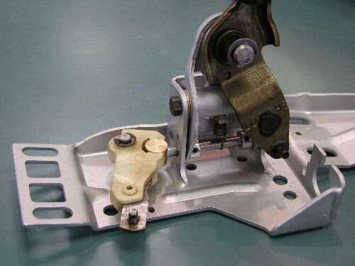

I've removed the shifter and taken it apart. "Brake-kleened" everything in sight. Lots of old congealed grease. No cracks.
Part of the shifter assembly is a plastic arm that is moved side-to-side by a "cam"(?) on the bottom of the select shifter assembly. That side-to-side goes through a pivot, and becomes forward and backward motion to operate the select cable. The cam is a snug fit in the hole in the arm. Snug enough to bind, just a bit. Too snug, I'm thinking. I intend to clearance that arm with some extra fine sandpaper, before lubing everything up, and putting it back together. (It occurs to me that the plastic arm may not have liked the Brake-Kleen, so I'm going to let it dry thoroughly before I do anything.
So... what is everyone using for lube when you reassemble a shifter? The service manual recommends chassis grease, but I'm sure there's something much more slippery, out there.

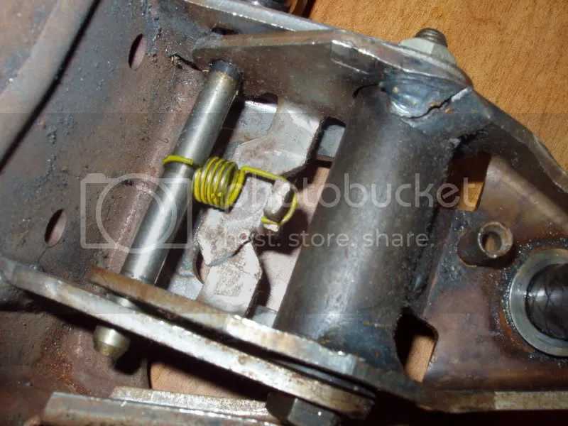

Another question... WTH is the spring for, that goes between the middle of the select arm, down to the steel rod at the bottom of the select arm.
This spring. (I should add that the bottom rod in my assembly has some collars that are locked in with set screws. It's not going anywhere.)
 Picture borrowed from Jncomutt's post. Thanks![This message has been edited by Raydar (edited 07-15-2022).]

Just looked at a Getrag shifter. In the car so can't see everything. I don't see a cam. It looks like a ball and socket affair. When the shifter moves the ball side-to-side it causes the end of the plastic/steel lever to move fore and aft due to where the pivot point is located I'm not sure if the plastic is just there to keep the ball in place or if it's the bearing surface. Actually the plastic reminds me of the plastic ends of the cable in the engine compartment so maybe it is the bearing surface. The spring seems to put some upward force on the ball - maybe to keep it in place. I like the Lucas tacky red grease although haven't used it on a shifter.
JUL 15, 10:16 PM

Ball and socket is probably more accurate. But it's not a ball, either. It's actually a cylinder shape, kind of standing on end. ("Cam" is all I could think of at the moment.) As the shifter moves side to side, it actually slides up and down in the plastic... bellcrank - as well as moving the bellcrank side to side. Interesting affair.
Edit - "I see", said the blind man. The shifter has already been rebuilt using Rodney's kit. It uses a cylinder instead of the ball, in the socket. It also includes the collars for the shaft, that are secured with set screws.
http://rodneydickman.com/pr....php?products_id=170[This message has been edited by Raydar (edited 07-15-2022).]
