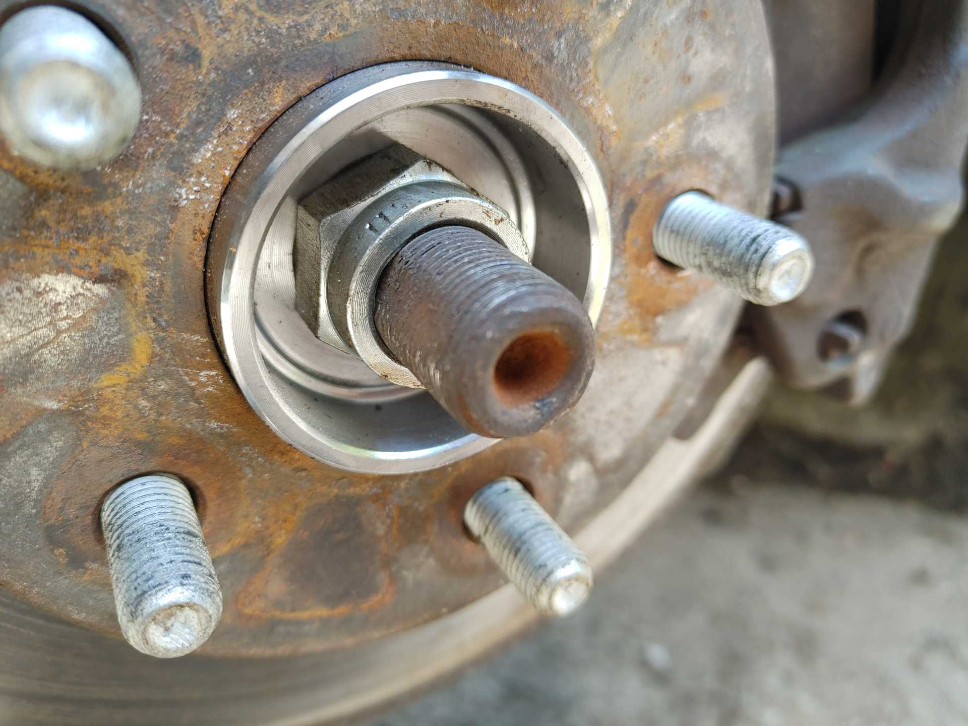

Is the axle splined into the hub? Post a photo looking at the axle/washer/nut for visual confirmation.
Well i do feel silly. My new hubs did not come with washers(they did come with nuts) and the old hub on the passenger side didn't have a washer either, so I foolishly assumed it must just not need one. Just checked and my drivers side does have a washer. Guess i'll source one for my passenger side...

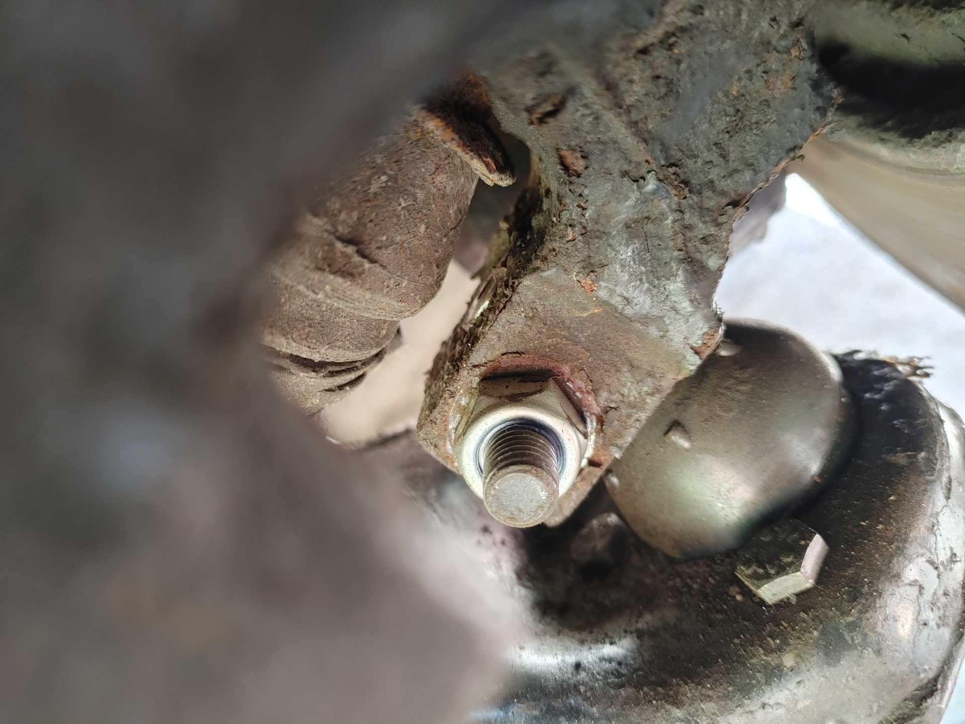

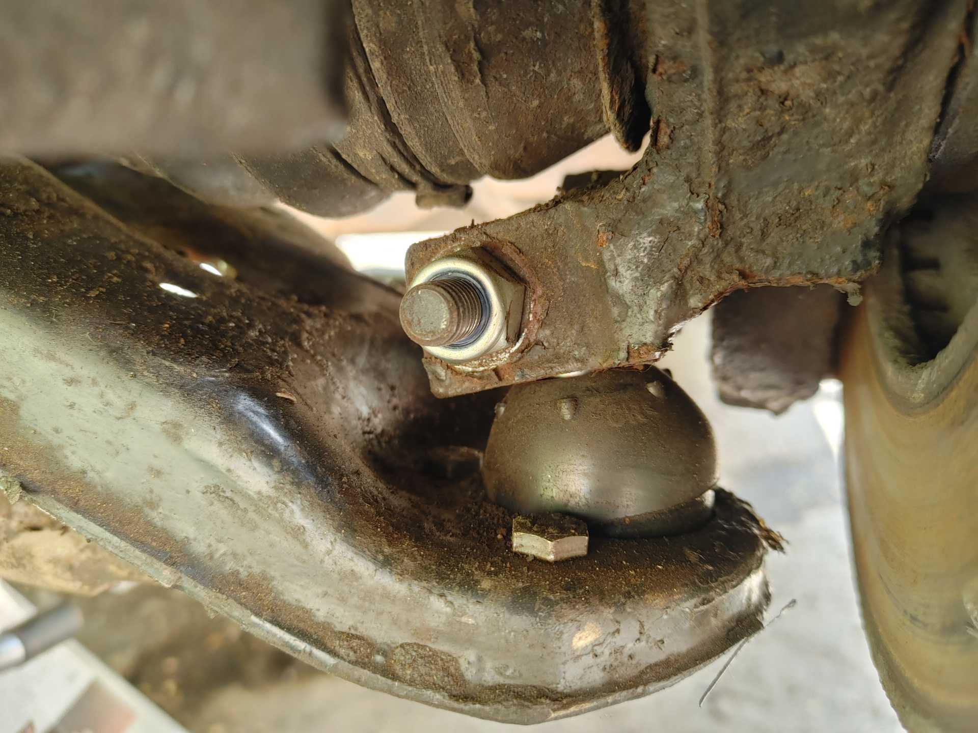

| quote | Is the rear knuckle fully seated onto the ball joint stud? (Don't assume it is, the rubber boot should be compressed by the knuckle and the top of the stud should protrude through the top of the attachment clamp at the bottom of the knuckle)
Again, to the best of my knowledge yes. I pushed the stud into the clamp until the groove lined up with the bolt hole, and allowed the bolt to slip right through.
Here you can see the top of the stud slightly protruding over the clamp.
And here shows the rest of the ball joints position
