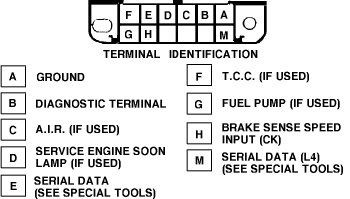

Don't forget most important part (ground diagnostic connector)
gatorfrey MAY 03, 09:37 PM
Where is this connector ? I also am timing my engine with a timing light in 2 days.

hunter29 MAY 03, 10:08 PM
Remove the cover , the one around the cigarette lighter, I believe it’s A and B. Double check that..

gatorfrey MAY 03, 10:57 PM
Thank you.
Patrick MAY 03, 11:03 PM
Keep in mind the ALDL port is sometimes flipped over when mounted.
