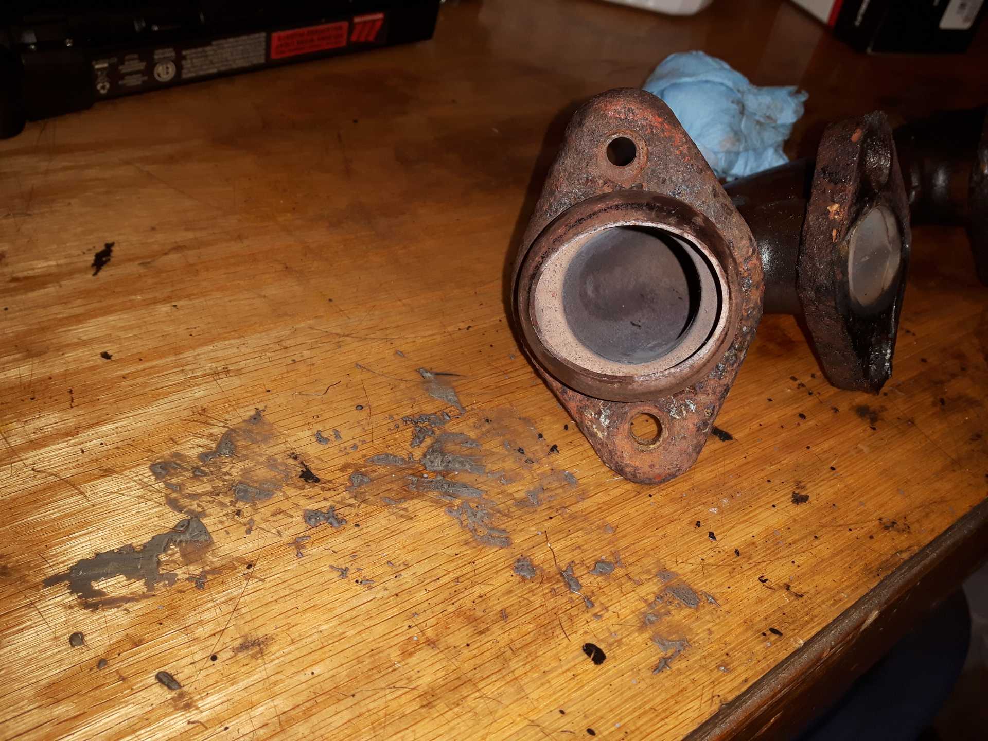

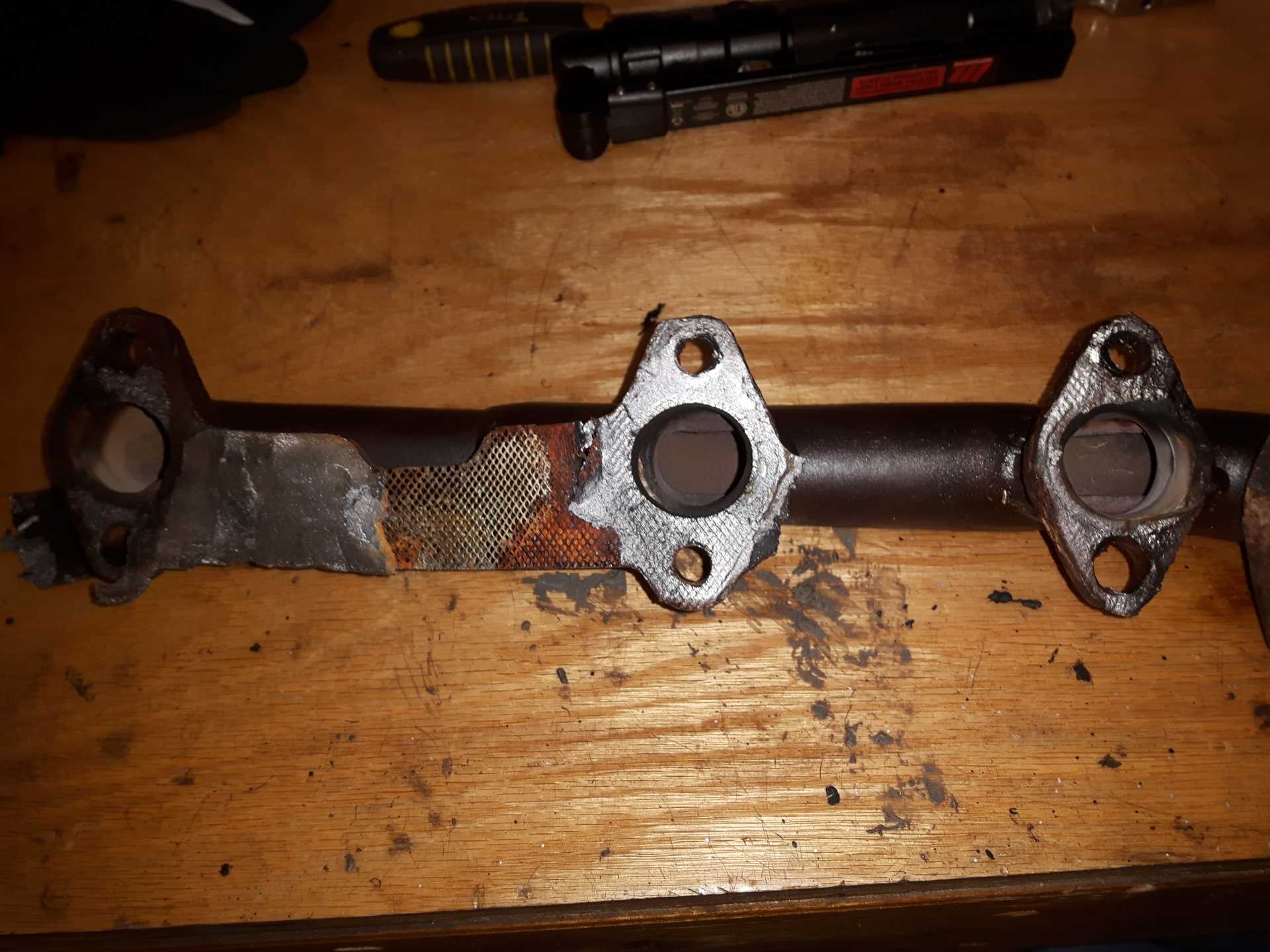

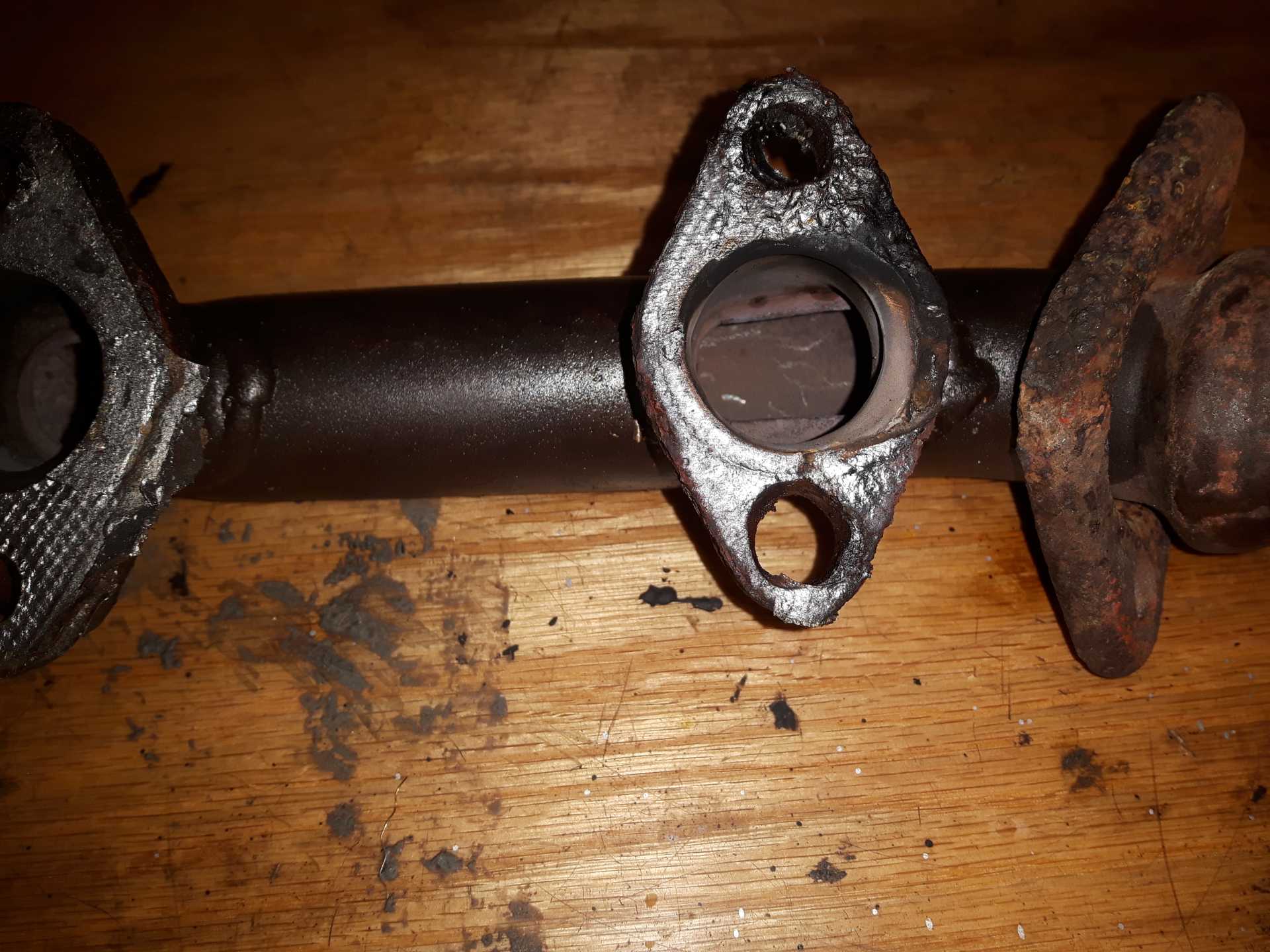

Well the car gods were good to me tonight. It was not the first time the exhaust manifold had been off. 3 of the nuts were just short of hand tight, the other ones were not too bad to get moving although the whole stud came out on one of them instead of just the nut.. There was already 1 stud that was replaced and it was replaced with an oversized stud. Picture below shows the enlarged hole on the manifold. It looks like only 1 of the 3 exhaust ports were anywhere near sealed.
I also discovered that the end of the manifold where it connects to the y pipe is shaped like an egg. I assume this is not the shape it should be based on how the y pipe is shaped. So that explains the leak at the Y pipe connection.

| quote | Originally posted by nero:
So I am on the hunt for a front facing manifold if anyone has one. I will also try out the mall.
With that being the one that usually cracks, finding a replacement will be a bit more of a challenge.
If you think your luck removing manifold bolts might continue, you should also remove the rear exhaust manifold so that you can port both manifolds. The exhaust will sound and flow better. It's good for a few extra ponies.
