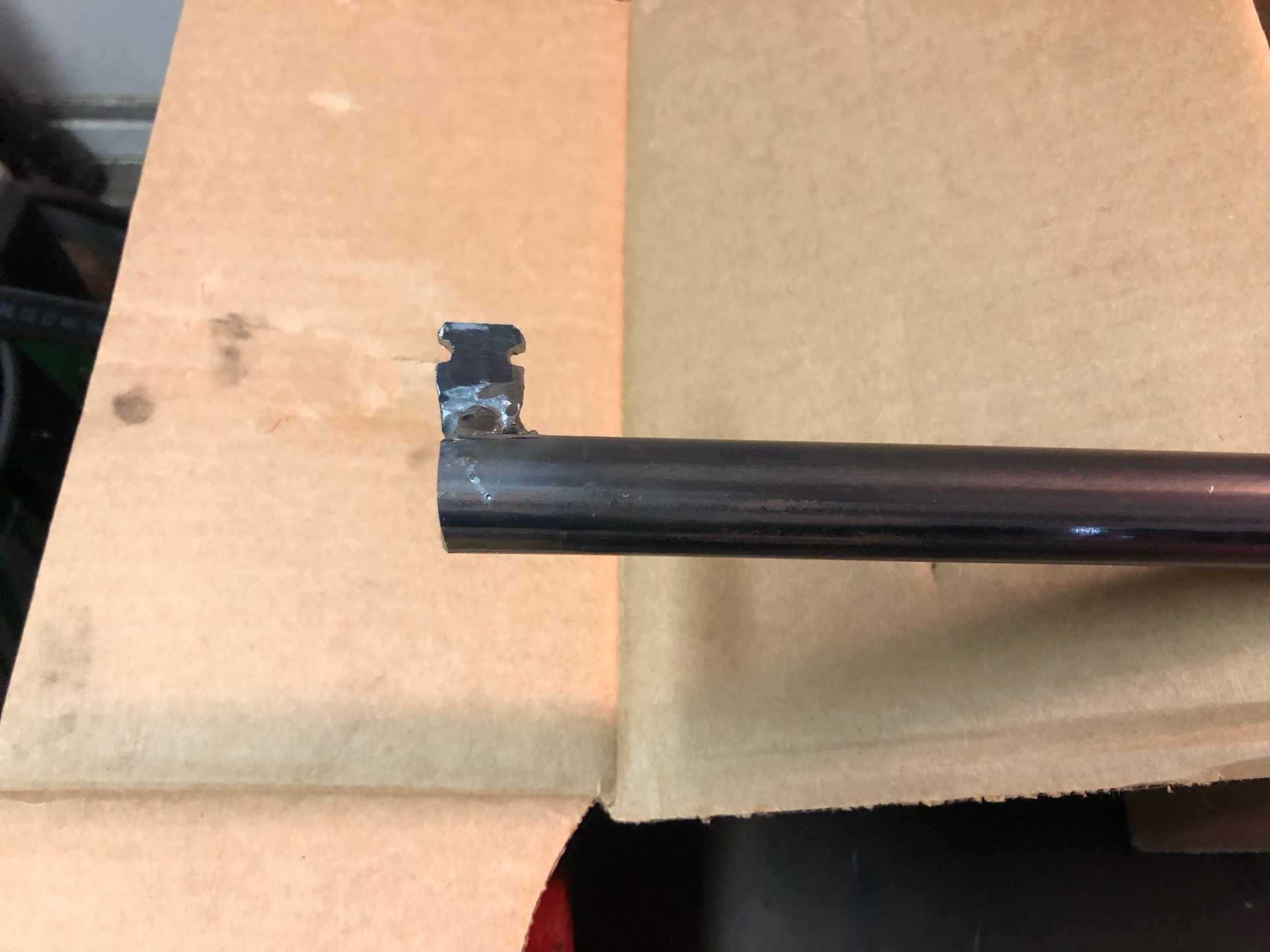

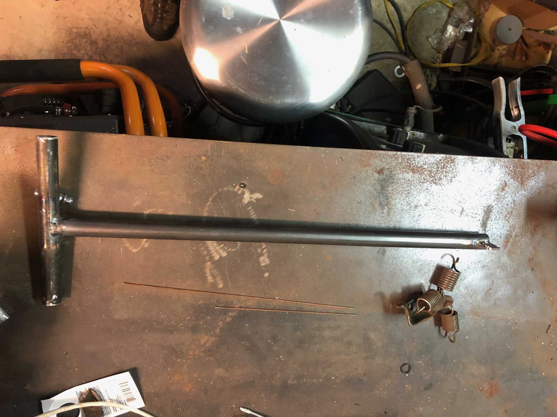

I went ahead and FaB-Re-Cated one of those nifty looking "Rodney Dickman" inspired "Spring Installation Tools" - And I made it big, lots of leverage.. I will be taking it to the shop tomorrow and giving it a whirl. If I cannot get them in with that, the springs are going in the garbage and I am going to use plain old hangars in their place.
Thanks kindly to everyone for the great input.
