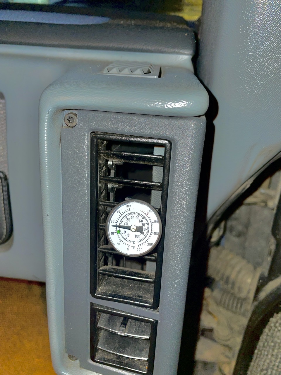

Idk in some older posts i read 25oz for 134a. When i did 32oz the system would reach high side cut off under acceleration. My cheap HF gauges were saying it was low but when i added 134a based on pressure and not weight it also cycled off at high rpm worse. I tried 25oz (because i could always add more)i never cycle off and it was freezing cold 38 degrees on a 80 degree day.

Success!
I didnt end up draining any oil, and just replaced the orifice tube with a non-variable one.
I added 36 oz of regrigerant, altho probably closer to 30-34 because I accidently took off the first one prematurely. high side guage showed 150, so I guess dont pay attention to the gauges to much.
It got cold by the second can but I just added more to see if I could get it lower, it got a little lower but not much.[This message has been edited by Xenoblast (edited 10-27-2021).]
